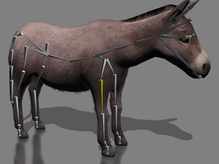

  • Bone Edit Mode: Activate to view the bone structure of the object for accurately picking the part of the object. Deactivate it to view in bounding box mode.
    Bone Mode.
    Bounding Box Mode (Wild animal content pack by reallusion only).

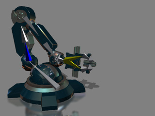

  3. Hold down the Ctrl key and click on a node to define it as the start of the IK chain. It will then be marked with a blue box (You may Ctrl click again to cancel the anchor).
    Please note that you may also click or Ctrl-click on the target node inside of the Edit Motion Layer panel.
  4. Pick another node to be the end node of the chain. (Ctrl key released)
    Ctrl-click to anchor the start of the IK chain.
    Click another bone as the end of the IK chain.
  5. Use the move gizmo to move the selected bone and affect the entire IK chain.
