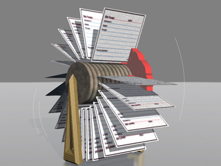

Duplicating Constrained Rigid Body
Given a rigid body already applied with constraint targeting to another physics objects, you are able to duplicate the rigid body with its constraint and the settings of the constraint. It is useful when you want to create a lot of constrained objects with same appearances and are referred to identical target.
Setting the Physics Structure
Apply a new prop. Set it as Dynamic rigid body and then apply a constraint
(in this case, a Hinge) to it.
The card is applied with a Hinge constraint.
- Set the parameter values for the physics object and the constraint.
Apply another object, set it as a physics object (in this case, a Kinematic).
The cylinder part is set as dynamic physics object.
Select the constraint and pick the cylinder as its target (the
one with green bounding box is the target).Note:
Please note that the constraint is under the dynamic object (in this case, the card) while the target rigid body (the cylinder) is an individual entity at the same level as the dynamic object's parent.
Duplicating the Constraint and Target
Select the constrained physics object only (the card).
Make sure the gizmo of object transforming tool is turned on (Ctrl + Q).
Duplicate the selected physics object. Please refer to the
Duplicating Props
section for more information.
Animate the targeted object (the cylinder) to view the physics
animation.
Please note that the duplicated physics objects will have individual constraints with identical target and physics settings.
