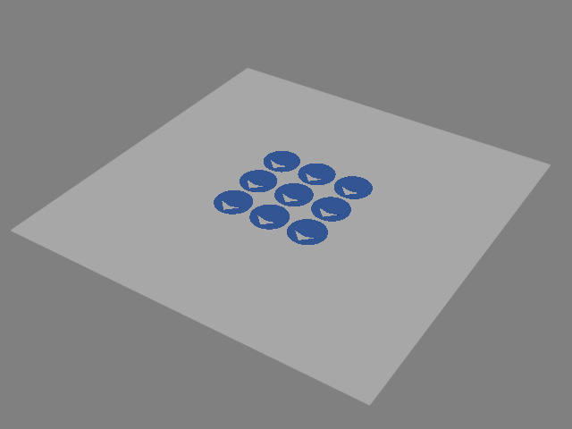

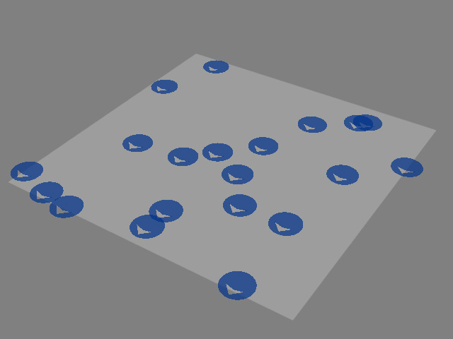

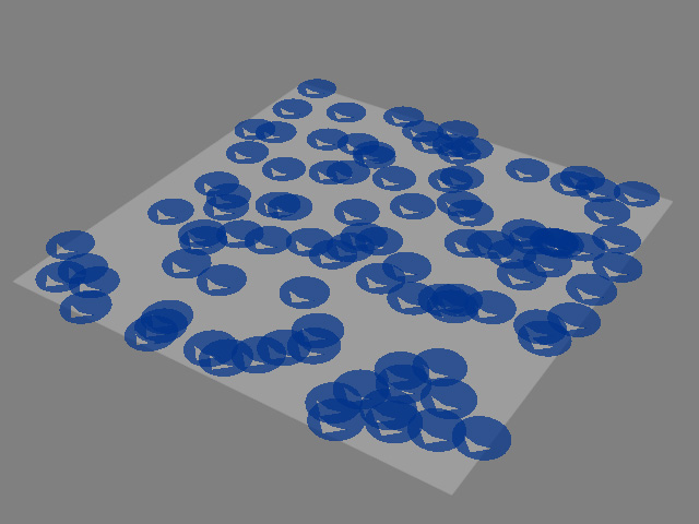

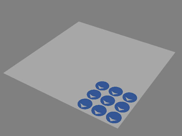

- Amount: The total number of scattered
actors.
Amount = 1
Amount = 100

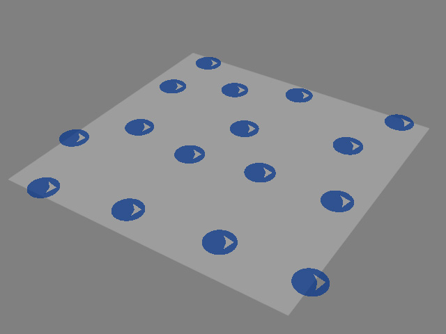

- Spacing (cm): The space between the scattered actors in centimeter.
Spacing = 0
Some of the tokens will overlap with each other.Spacing = 200
With adequate spacing, there will be no overlapping. - Orientation: The unified direction for each marker.

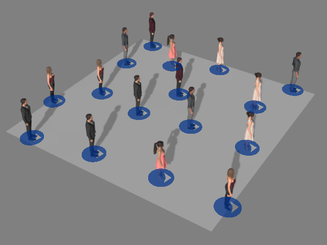

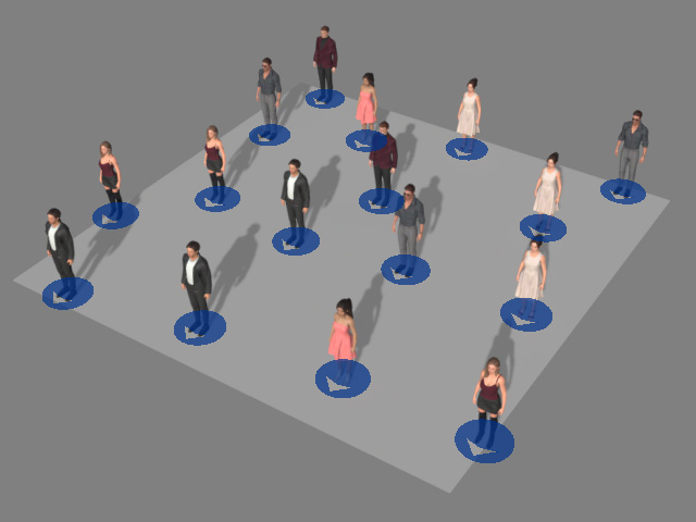

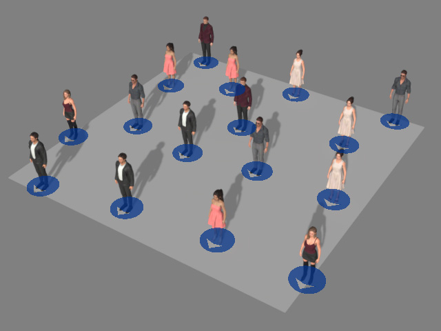

- Random Orientation controls the individual direction for each
marker.
The direction will individually affect the angle for each placed actors.Random Orientation = 0.00
Random Orientation = 100.00
For more information, see Adding Focal Points for Actor Orientation.Random Orientation = 0.00

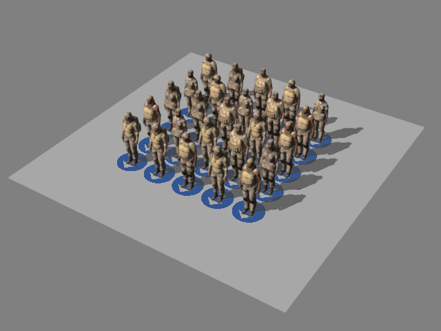

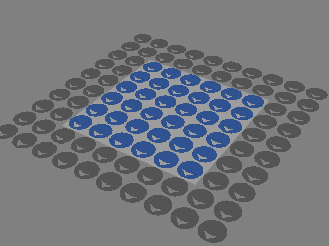

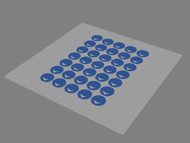

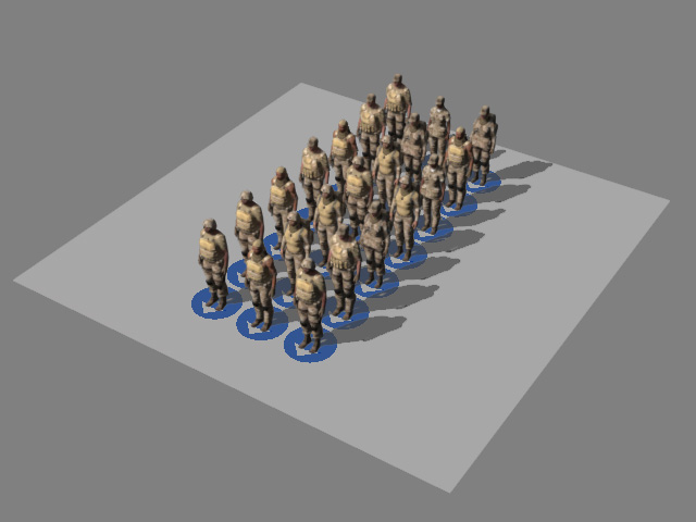

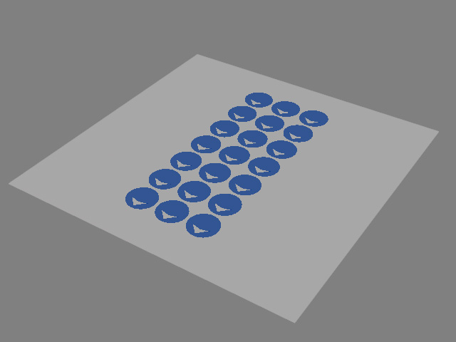

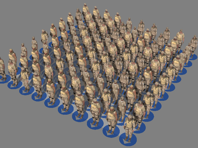

- X Amount / Y Amount: The total number for
arrayed actors. The maximum numbers for X and Y are 100.
Notice that the gray markers are out of bounds, therefore,
they will not be occupied.
XY Amount = (10, 10)
The range prop is scaled down.XY Amount = (10, 10)
XY Amount = (5, 16)
The grey markers remain empty. - XY Distance (cm): The space between the distributed props in centimeters.

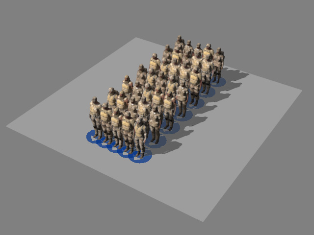

Click the Deploy Actors button to preview the distribution.XY Amount = (5, 7)
XY Distance = (50, 100)XY Amount = (5, 7)
XY Distance = (100, 100)
You can activate the Use X Distance as Y checkbox to synchronize the XY values.XY Amount = (5, 7)

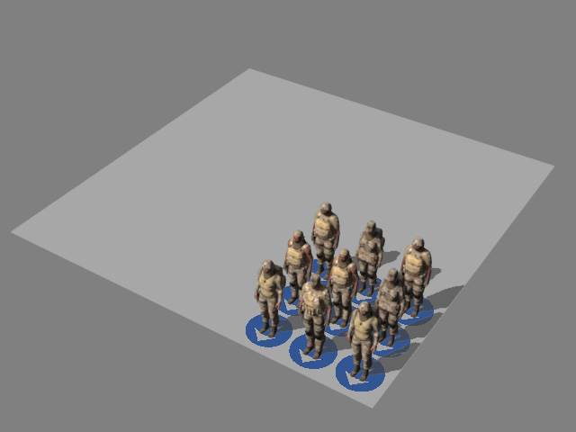

XY Distance = (100, 100) - X, Y Offset (%): The X and Y offset values translate the entire array on the X-Y plane.
Click the Deploy Props button to preview the distribution result.X, Y Offset = (0, 0)
X, Y Offset = (0.65, -0.65)

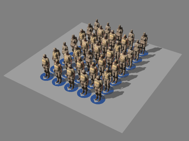

- Orientation: The direction for the entire array.
Click the Deploy Actors button to preview the scattering result.Orientation = 0 (degrees)
Orientation = 45 (degrees)
