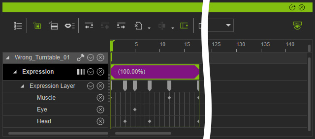

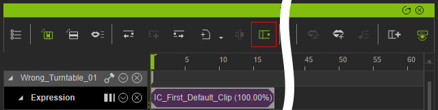

Make sure the Auto Extend Clip feature is turned OFF.

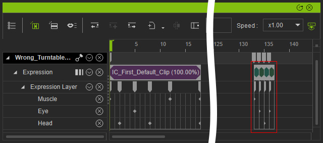

Open any clip track (animation, motion, expression, etc.) with sub-tracks.

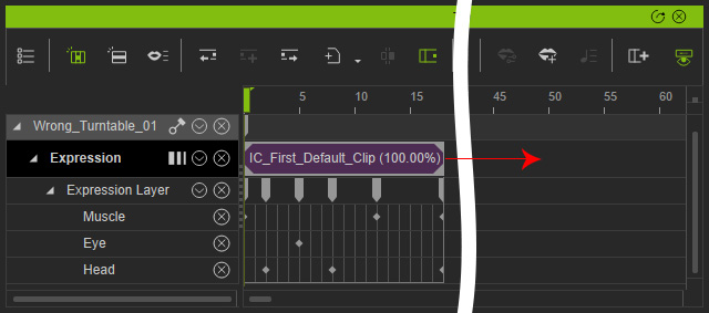

If you add any keys to the sub-track of the clip track, then you will create another clip that includes the keys, because the Auto Extend Clip feature is turned off. - Press down the Resize Clip button on the Timeline Toolbar.

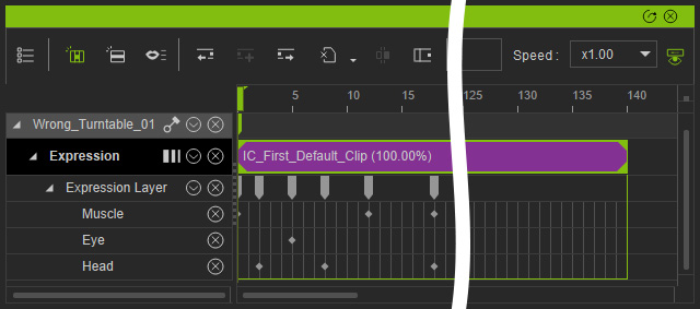

- Drag the right side of the clip to resize it.
*Dragging on the left side of the clip does not work to resize the clip. - As you can see the clip is extend with the original data untouched.

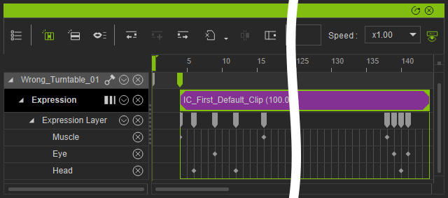

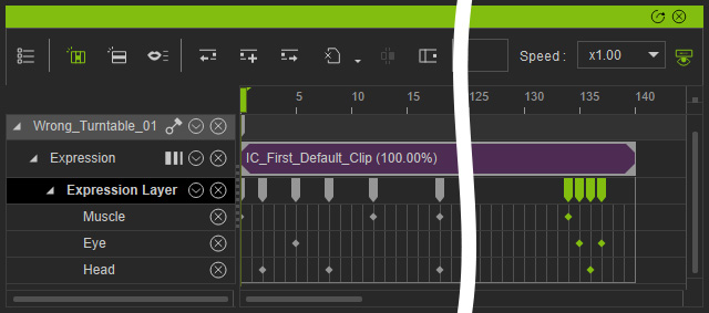

- You can then insert more keys into this clip.

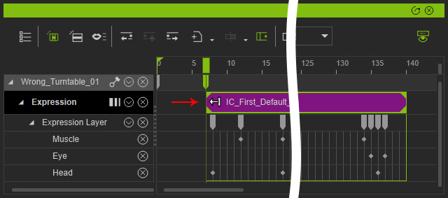

These keys then can be moved along with the clip. - You can also drag the left side of the clip to resize it.

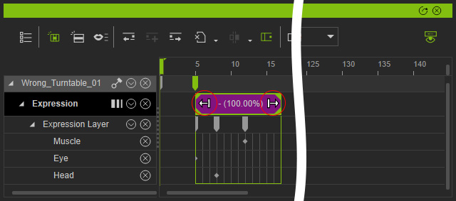

** When the clip is resized shorter than the original range, arrow icons will appear on the sides that indicates some data is hidden.- Original clip
size:
- Resized clip:
Some data is cropped outside the resized clip.
