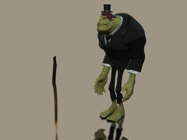

Reach Mode - Reach Object

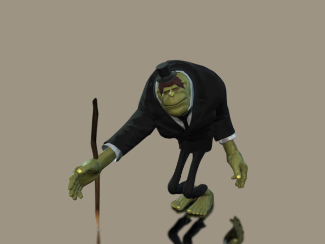

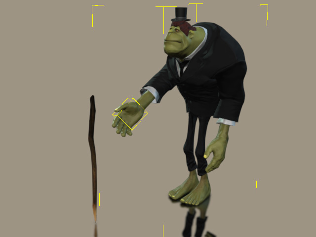

Apply a character and a target object, like this stick.
Have the character's right hand point at the stick (Select Target button clicked). Please refer to the
Using the Reach Target Panel section for more information.

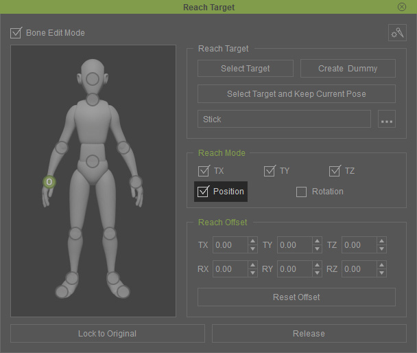

If you wish for the hand to make contact with the target, then activate the Position checkbox.
- The character's hand will snap and align to the
pivot of the target.

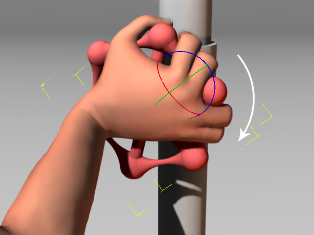

Reach Mode - Rotation

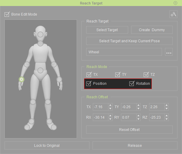

Reaching body parts can often penetrate with target objects that have rotational animation applied. By activating the Rotation checkbox in Reach Mode, the body parts will not only touch the target object, but also follow its orientation.

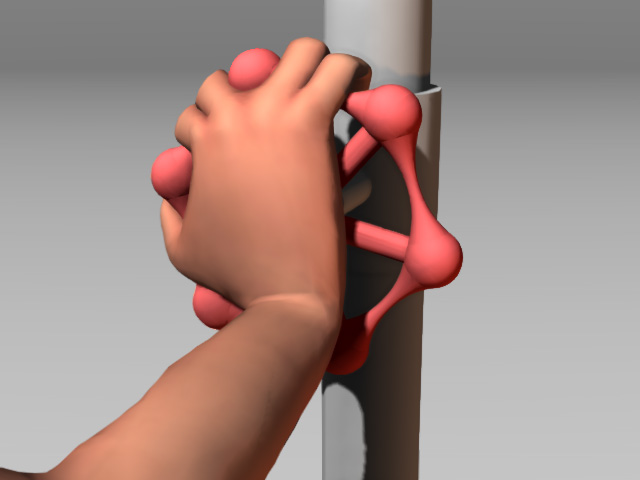

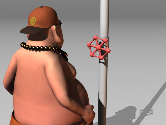

Apply a character and a prop.
- Have the character's right hand reach out and touch the target prop (Select Target button clicked).
Activate the Position and Rotation checkboxes to ensure that the character's hand touches the target and rotates along it. -
Set rotational keys on the prop.
Playback and you will see the character's hand rotates along the prop's animation.
