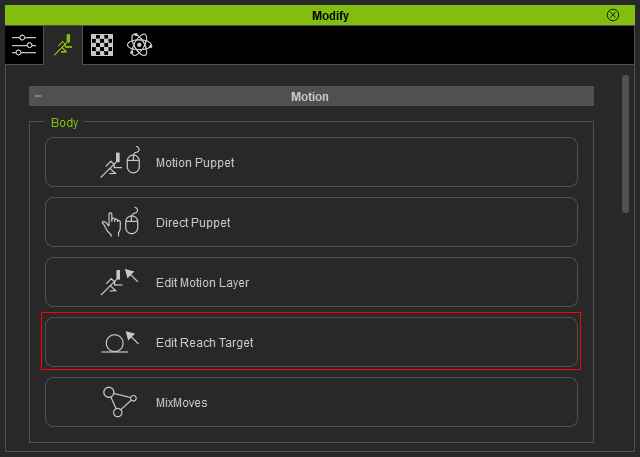

Pick the character,
click the Edit Reach Target button under the Animation tab of the Modify panel.

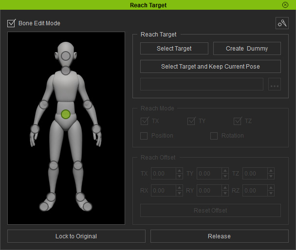

The Reach Target panel will pop up. -

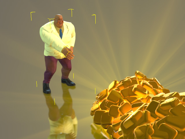

Select the right hand effector point from the left dummy pane.
Click the Select Target button, and

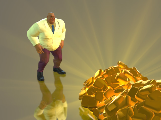

then pick any object on the 3D preview window to specify the target (the gold pile on the ground
in this example). The character will reach out with the right hand and point at the object.

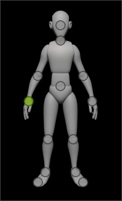

- The right hand
effector point will turn
from
to
; which indicates that the corresponding body part is pointing at an object.

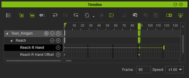

You will see a new reach key added into the Reach track of the corresponding body part.Note:
Please note that the body part of the character only points at the target after this step.
Optionally change the hand gesture so that the character really looks like its pointing at the target.

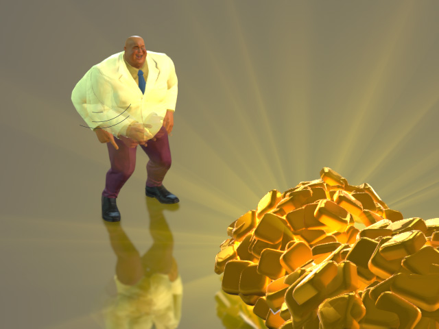

- Move to another forward time frame. Select the same effector point and then click the Release button.
The character then stops pointing at the target (the character gradually puts down his right hand).
- You will see a new release key added in the timeline.
- After releasing the target, you may then have the character point at another object.

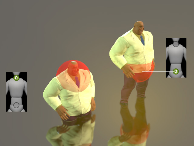

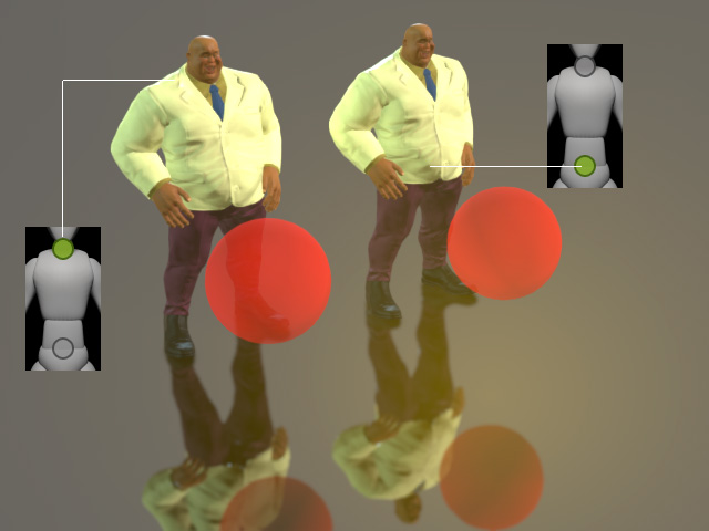

If you set Reach Target keys to the Pelvis or Chest
effector points, then they will instantly
snap to the target's pivot. You can drag them back where they are by
Keeping the Original Poses or Motions to the
effector points of the limbs.
