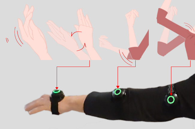

If there is only the body mocap device mounted on your computer,
then there is no priority issue.
The hand flipping and arm rotations will be completely controlled by this device.

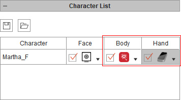

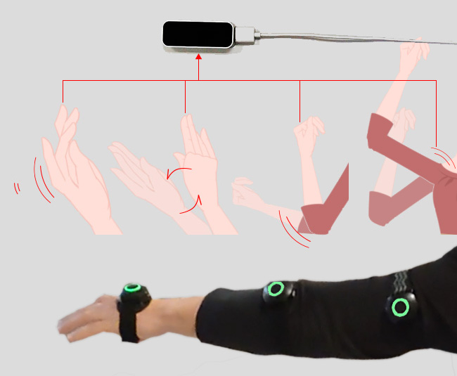

If you mount a hand mocap device and set it to Upper Arm IK Mode,
then it will have higher priority than the body mocap device.

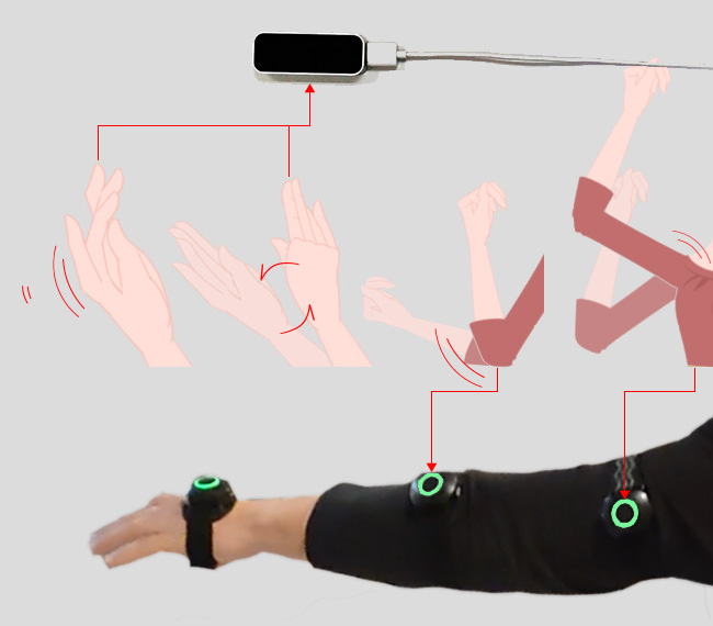

When the hand motion device is set to Hand Mode,
then the rotation of the elbows and shoulders will be released and be controlled by the Body Mocap Device.

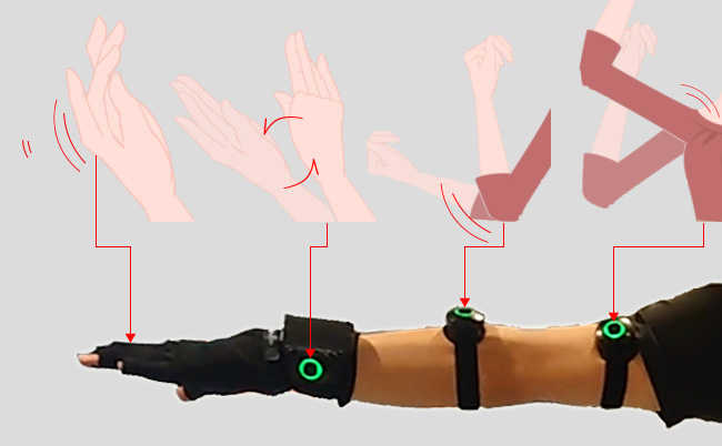

If you use Perception Neuron with its Gloves for Body Mocap and Hand Mocap,
the rotation from shoulders to wrists will be controlled by Perception Neuron.
