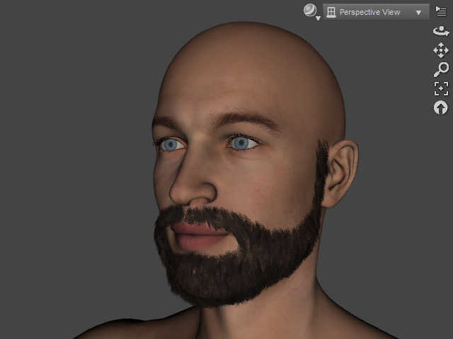

In order to convert smart hair, the G8 character from DAZ 3D is taken as the base for bringing the hair into Character Creator.
Exporting Character with Facial Hair from Daz 3D
- Create a character in DAZ 3D with facial hair already applied.

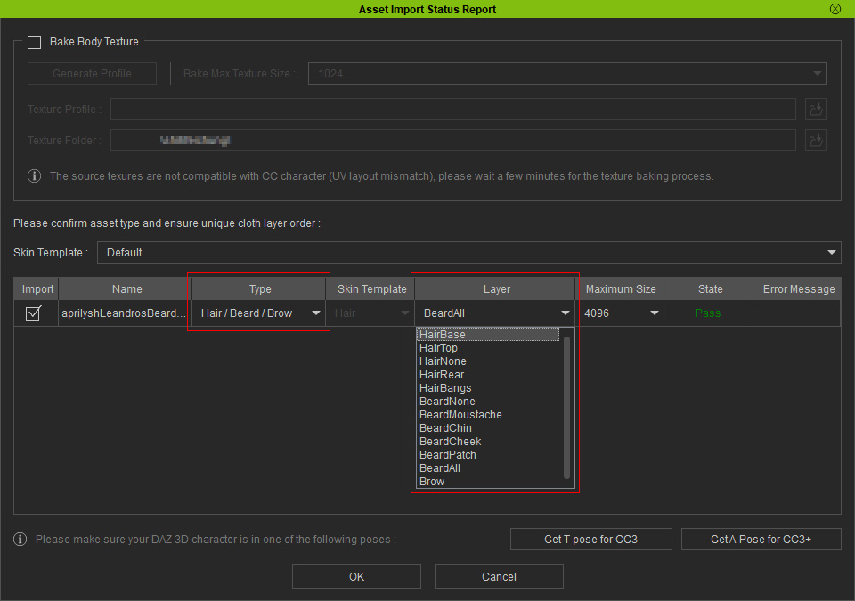

- When you encounter the dialog box, click on the BASIC button for auto-detecting and loading all textures the character ever be applied with in DAZ.
- In the Asset Import Status Report panel, set the hair's Type to Hair / Beard / Brow. And set the region to which the hair should belong from the Layer drop-down list.
You can also set the textures' sizes after baking by choosing from the Maximum Size drop-down list.Note:

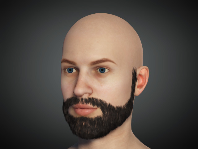

- Click OK to import the character and its assets. The Facial Hair is thus converted successfully in Character Creator.

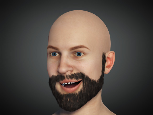

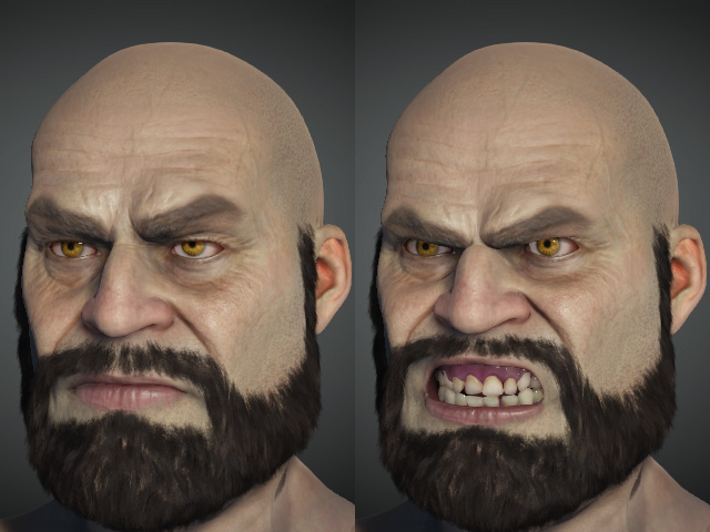

- Make facial expression for the character and you will find the hair is automatically set with skin weight in order it animates along with the expressions.

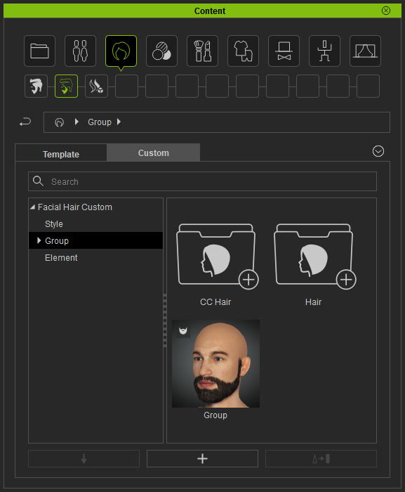

- You can add the facial hair to the Content Manager's hair Style, Group or Element libraries.
- The template can be applied to any other character.
