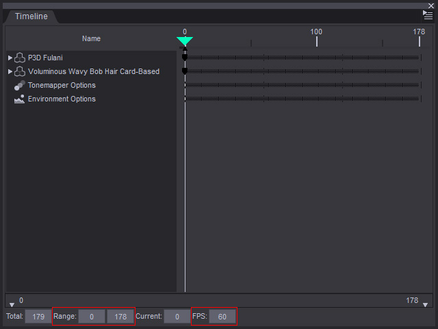

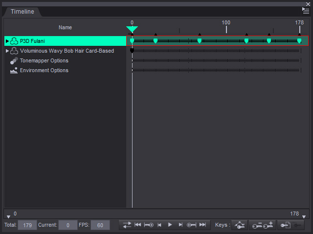

Converting the character to Character Creator in Basic or Advanced mode. - Open the Timeline and set the start and end frames to determine the project range.

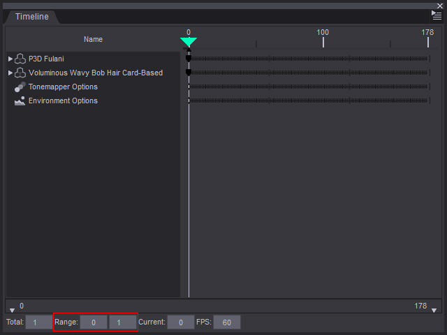

- For generating a pose: set the range to only 1 frame to include the pose.
- For generating motion with poses: set the range to include all poses.

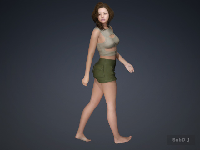

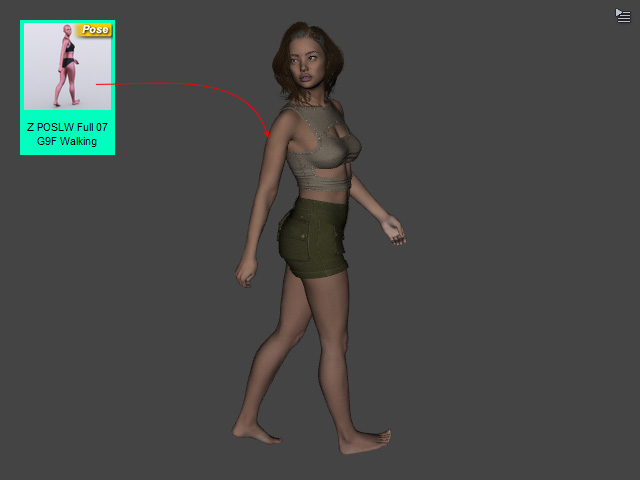

- In the first frame, apply a pose from the Content Manager.
** Notice that you are allowed to apply various poses at different timeframes within the project range to create pose animation.

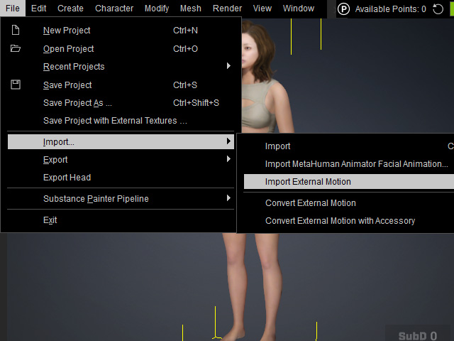

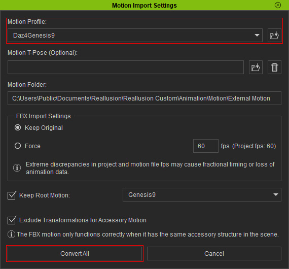

- Make sure the character is selected and go to File > Import > Import External Motion.

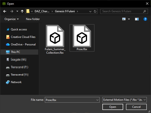

- Select the FBX file of the pose exported from DAZ Studio previously.

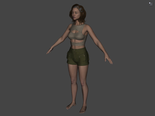

- The Characterization profile will be automatically set up. Click the Convert All button.
As you can see, the pose will be imported.

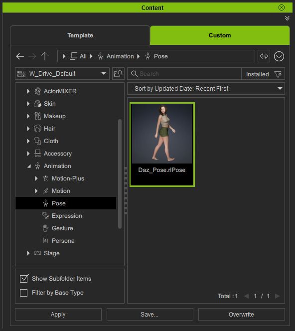

- You can save the pose to the Custom Pose library.
