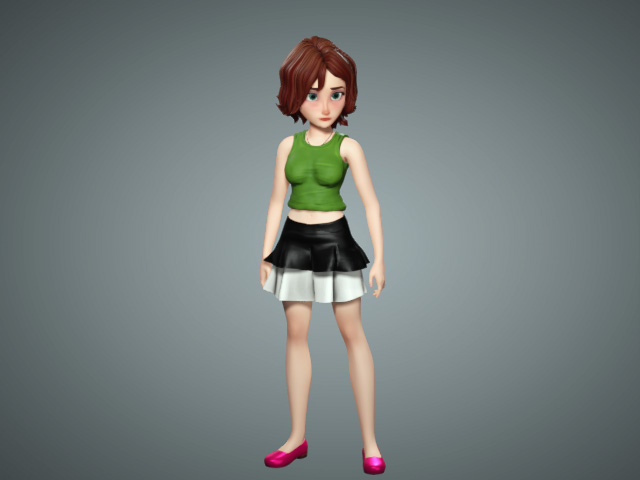

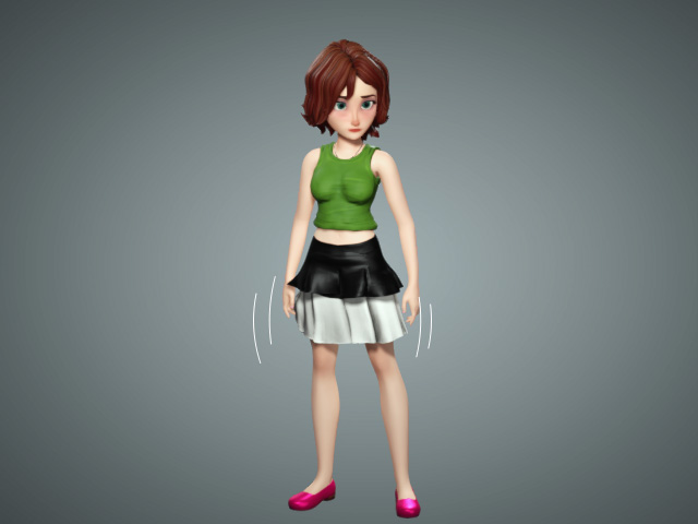

Play back to view the result (the edited skirt changes to a different texture
and drapes downward slightly more).
