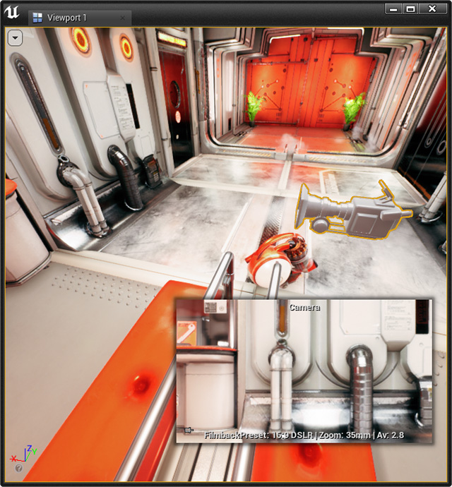

- You can see the transferred cameras listed in the World Outliner panel in Unreal.
- Select either of the cameras and a mini-view of the camera's perspective shows at the bottom right.

- In Unreal, right-click on the desired camera and choose the Pilot '[CAMERA_NAME]' command from the context menu.
The viewport in Unreal will then switch to the view of the picked camera. - Edit or animate the camera(s) in iClone (the cameras are moving along paths) and the corresponding assets in Unreal will be instantly driven to move.
