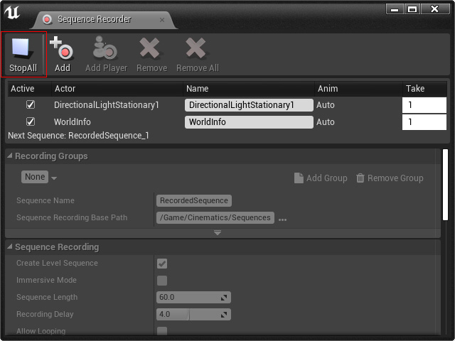

  2. Open the Sequence Recorder panel, click the Add button to add the light into the list.
  3. Press the Record button to start recording.
    The Unreal viewport will start to countdown.
  4. Play back the project in iClone to animate the light after the countdown ends.
  5. Click the StopAll button in Unreal after the iClone project finishes.
