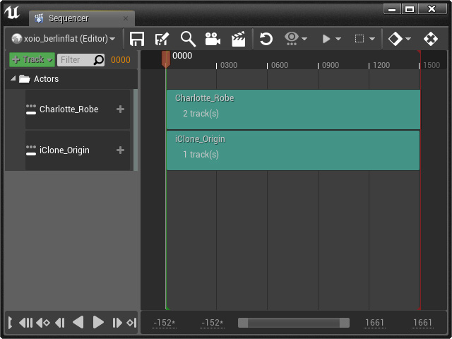

  6. By default, the recorded file is saved in Content > Cinematics > Takes > (Date) folder. You can open the Takes Browser to find the take.
  7. Double click on the take and you can see all the character's motion data in the Sequencer panel.

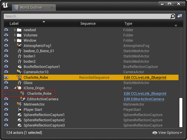

  1. Select the character in the recorded sequence (marked with a lightning bolt).
    * It is recommended that you hide the original character from the scene for better observation.
  2. In the Live Link section on the Detail panel, delete the Subject Name.
    Keep in mind that this step ensures the character's motion come from the recorded sequence instead of the character in iClone.
    Alternatively, you can remove the source from the Live Link panel instead of deleting the Subject Name of the character.
