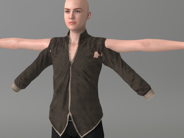

- You can pose the character to check if any skin weight result is inappropriate.
- If there are any flaws, then select the piece and click the Modify > Attribute > Modify > Skin Weights.

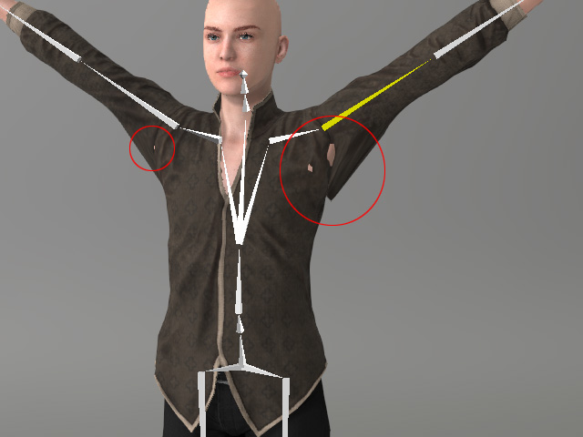

- Right click on the bone that are supposed to influence the vertices currently move incorrectly.

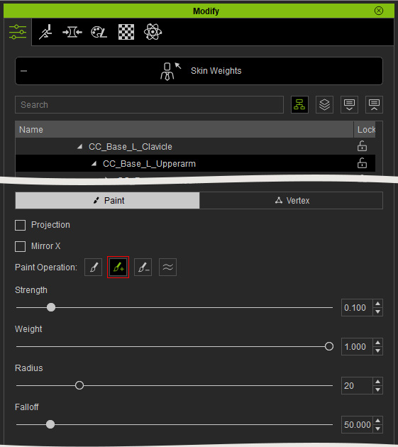

- In the Skin Weights mode, switch to the Paint tab and press down the Add button.
Note:- Strength (Shortcut: B key + drag with left mouse button) and Weight (smooth brush is excluded): These two values determine the final weight painted on the surface. And the formula is Strength x Weight.
- Radius (Shortcut: B key + drag with right mouse button): The diameter of the brush.
- Falloff (Shortcut: B key + drag with middle mouse button): The status of the color gradient on the edge for each brush stroke.
- Refer to the Introduction of Skin Weight Brush section for more information about the settings in the Paint mode.
- Hover mouse cursor to the piece, you will see the red circle which represents the painting brush.

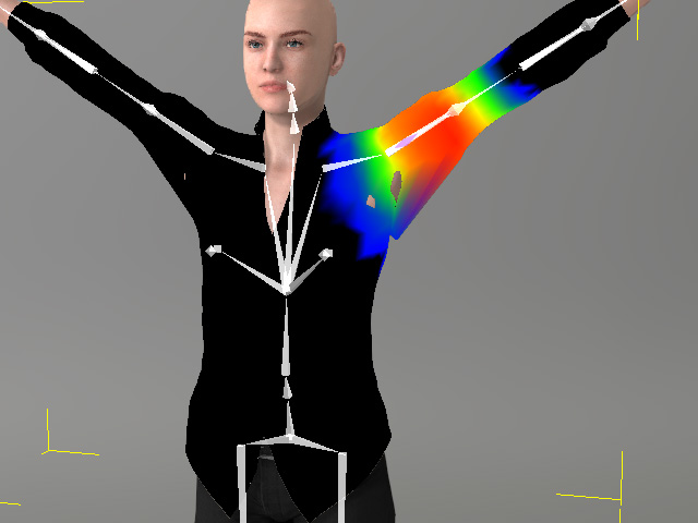

- Paint on the vertices that are supposed to be controlled by the picked bone. You will see the vertices change their position instantly.

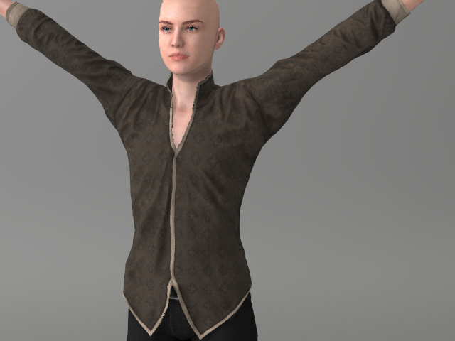

- Repeat the same steps to any other vertices that moves oddly. Click the Skin Weights button again to leave this mode after you have fixed all the flaws.

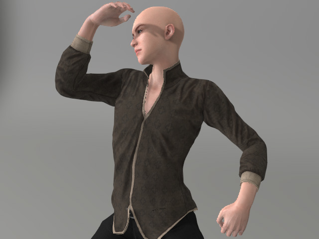

- You can then set different pose for the character to check if any defects exist. Repeat the same steps if necessary.
