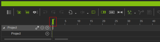

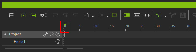

- Move the start marker to 0 and go to the start frame.

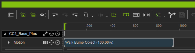

- Drag and drop a motion or expression file (FBX, imotion, rlmotion, italk, iMotionPlus) onto the character.

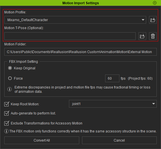

About Importing FBX:You will encounter the Motion Import Settings dialog window when importing an FBX motion file. This panel is used for characterization motions to the Reallusion skeleton system.

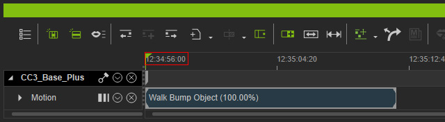

- Adjust the project start frame timecode.

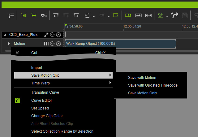

- Save the motion as a new file:
- Right click on the clip and perform Save Motion Clip:
- Save with Motion: Save the clip as rlMotion or iMotion format and leave the clip's timecode settings untouched.
- Save with Updated Timecode: Save the clip as rlMotion or iMotion formats with custom timecode set in step 4.
- Save Motion Only: Save the clip as rlMotion or iMotion formats without timecode value.

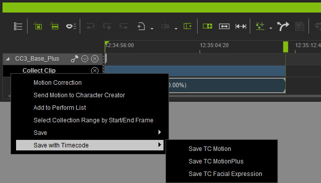

- Export the motion via Collect Clip > Save with Timecode (compatible formats include rlMotion, iMotion, iMotionPlus and iTalk).

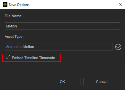

- Save into Smart Content Manager: You can integrate the timecode with the motion file when you click Smart Content Manager > Save.

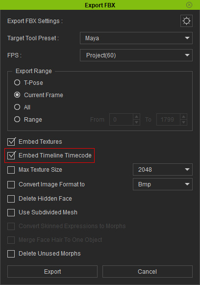

** Notice that the length of the saved motion file will be identical to the project duration, not the original clip length. - Export FBX (File > Export > Export FBX): You can include timecode with the FBX file by enabling Embed Timeline Timecode.

- The FBX files embedded with timecode data can be used in Unreal, Maya, Motion Builder and so on.
