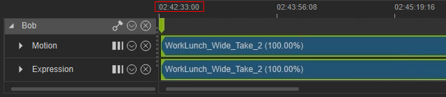

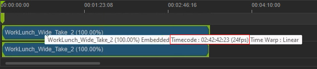

Check out the timecode of the clip on its tip.
- Manually set the approximate start timecode of the project in accordance with the timecode of the clips.

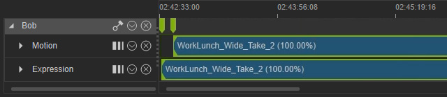

- Right-click on one of the clips and choose Align Clip to Embedded Timecode.
The clip will be repositioned to an accurate timeframe.
Repeat the same step for the other clip.

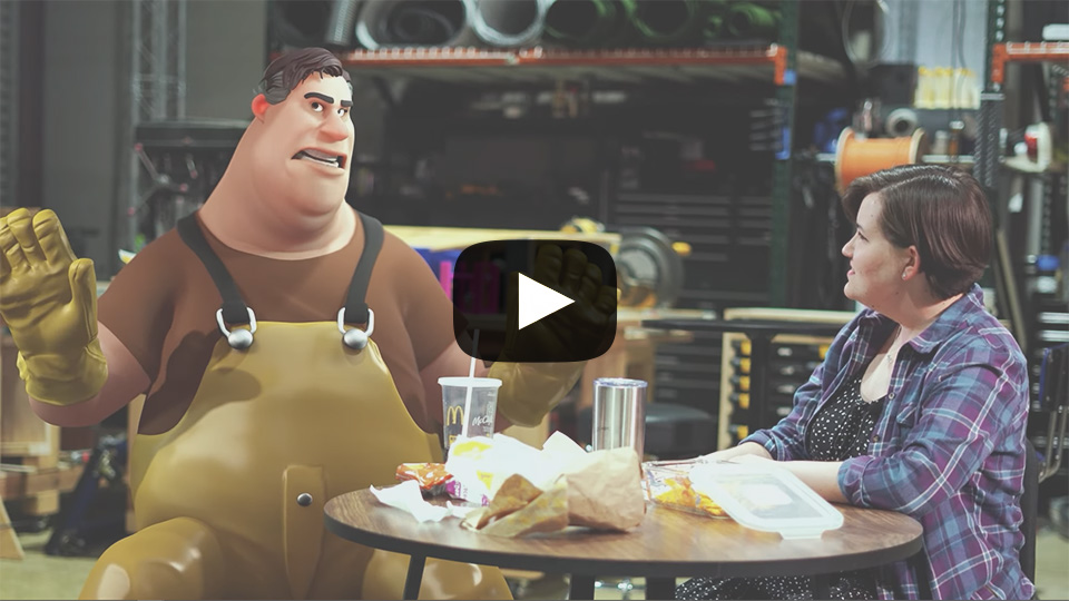

- Open the Project panel and double click on the slot in the 2D Background section to load the timecoded video (from step 1).
- The video will be deployed as a 2D background to the scene.
