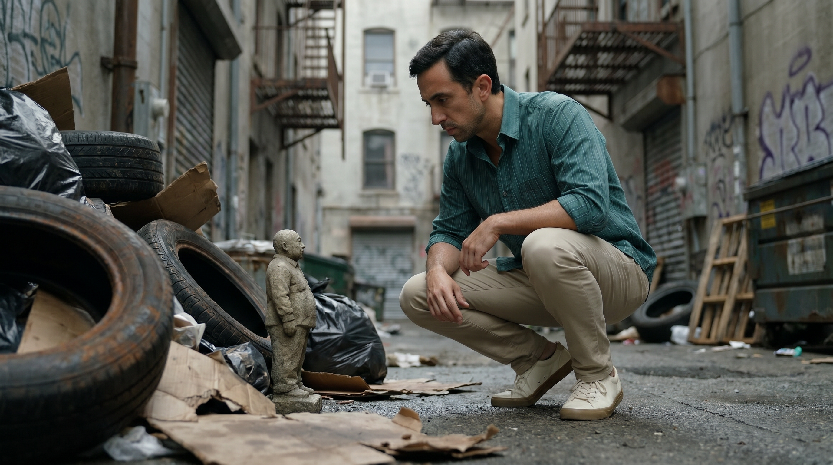

In this example, the video begins with one actor appearing at a very small scale in the Start Frame and gradually enlarging throughout the sequence. Compare the AI outputs with and without references to see the benefits of reference-driven character consistency, particularly when handling extreme scale changes, camera angle variations, or content generated from 3D previz scenes with gray-model characters or objects:

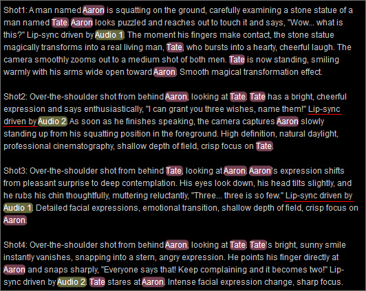

Prompt
  • Without an AI Actor reference, no actor tags are highlighted for Aaron and Tate, making them less clearly recognized by the AI and resulting in low character consistency in the generated video.
  • Without an audio reference, the characters’ voices lack a distinct identity.
  • With an AI Actor reference, actor tags such as Aaron and Tate are highlighted to help the AI recognize each character, ensuring high consistency in the generated video.
  • With an audio reference, adding "Lip-sync driven by [Audio]" to the prompt enables generation of distinct character voice audio.
