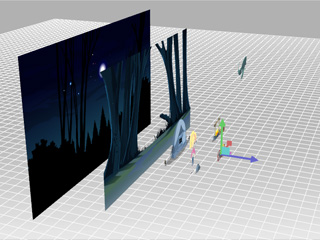

G
3D View
(Stage Mode only)
Click this button to switch to 3D mode. You can then check the Z-depth relationships of each character and object inside the working area.

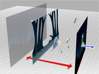

  • Drag inside the working area with the left-mouse button to view the Z-depth relationships.
  • Drag inside the working area with the right-mouse button to move the camera to different angles inside the working area.
  • Drag the Blue gizmo handle of the select object to change its Z-depth.
Please refer to the Transforming inside the Working Area and Creating a Path Animation sections for more information.
