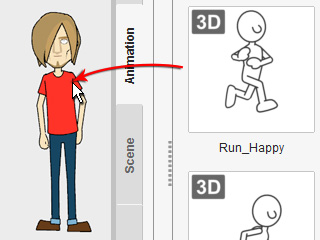

Apply a G2 character.
Apply a 3D motion from the
library.
If necessary, then
loop the motion clip
(in this case, looping three times).
The character will start to perform the applied 3D motion.

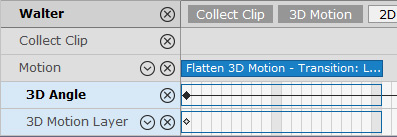

Open the Timeline (F3) and the Motion track of the character.

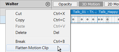

There may be already some motion layer keys within the Motion Layer track in order to refine the clip. -
If you want to keep the results of the keys, please right click on the clip and
execute the Flatten Motion Clip to merge the keys into the motion clip.
Execute the Flatten Motion Clip command.
The motion layer keys are merged into the clip (a new one will be added in the start time frame to ensure the first body gesture).

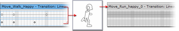

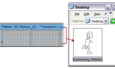

After the refinements are done, you can convert the motion clips and the keys into 2D motions (*.ctMotion) with specific angle so that you can do the further 2D modifications.

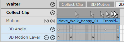

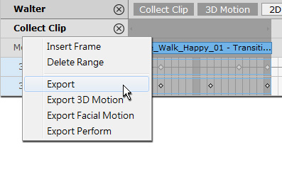

Open the Timeline (F3) and the Collect Clip and Motion tracks of the character.
Drag within the Collect Clip track to determine a range for exporting an angular 2D motion.
Right click within the range and execute the Export command.
You will be prompted to set a location for saving this new 2D motion clip with the keys (including the Angle keys) merged into it.
Note:-
If you execute the Export command, then the keys within the Angle and Motion
tracks will be flatten and merged into the clip. You
CAN NOT edit the keys
after applying the new clip again.

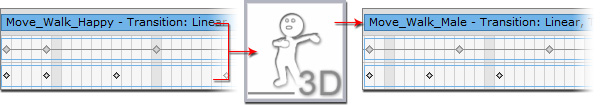

On the contrary, if you execute the Export 3D Motion command, then the keys will
not be flattened and merged, you are able to apply and edit
the clip afterward.

Apply the new 2D motion back for further 2D editing, such as Sprite Animation,
Transformation or Deformation.
Note:- A 2D motion is gray while a 3D one is light blue.
- Please refer to the Using 2D Motions section for more information.
