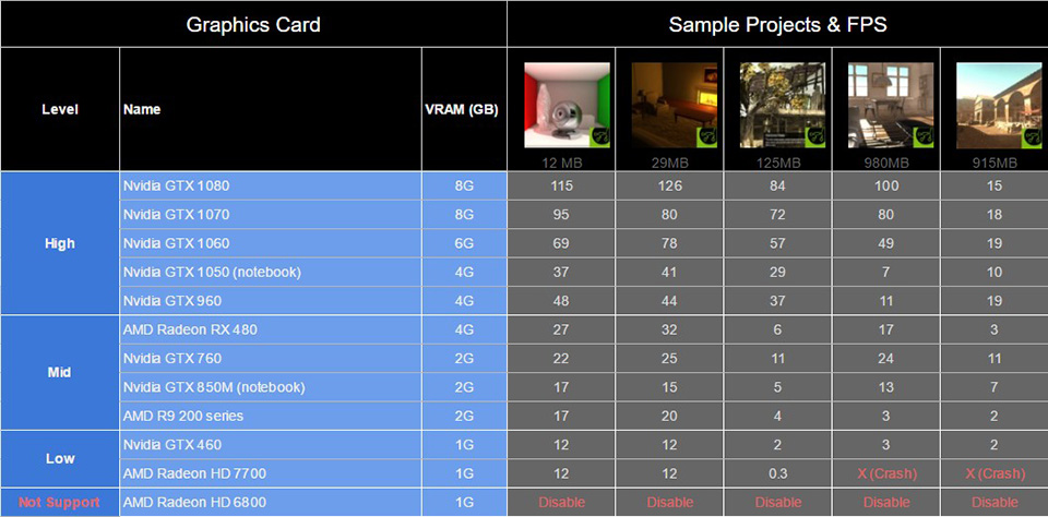

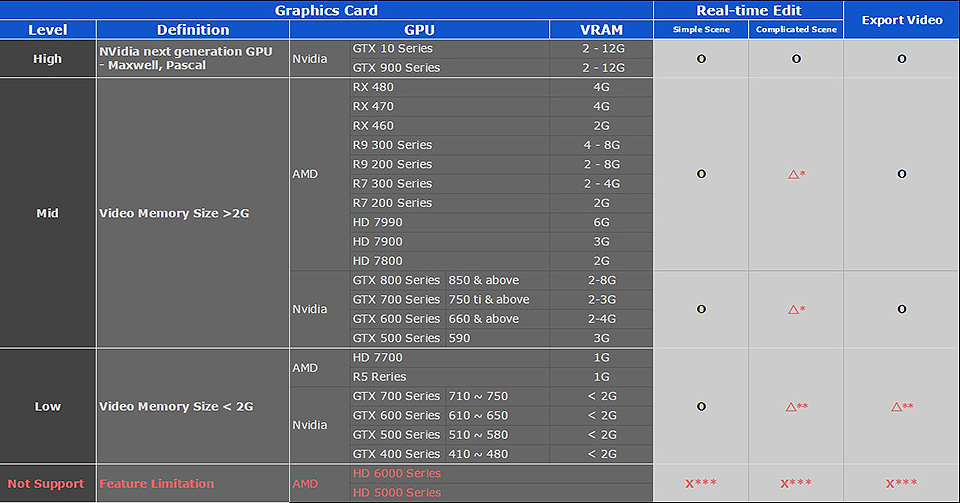

III. iClone Real-time GI vs. Graphics Cards
The current Graphics card market can be separated into three levels. The following chart provides the test scenerio and FPS data:
- Graphics Card Definition
- * It is suggested to turn off View-port GI for smoother editing experience on complex scenes.
- ** You might encounter iClone crashes when loading complex projects, possibly due to exhausted system / video memory.
- *** GI related features are fully disabled in iClone, no GI render for view-port or export
Note:For graphics card specification please visit the website for NVidia and AMD.
- Performance Test Result
- iClone FPS UI display, the max is capped at 60 FPS.
- This table will be updated in 7.0 final release.

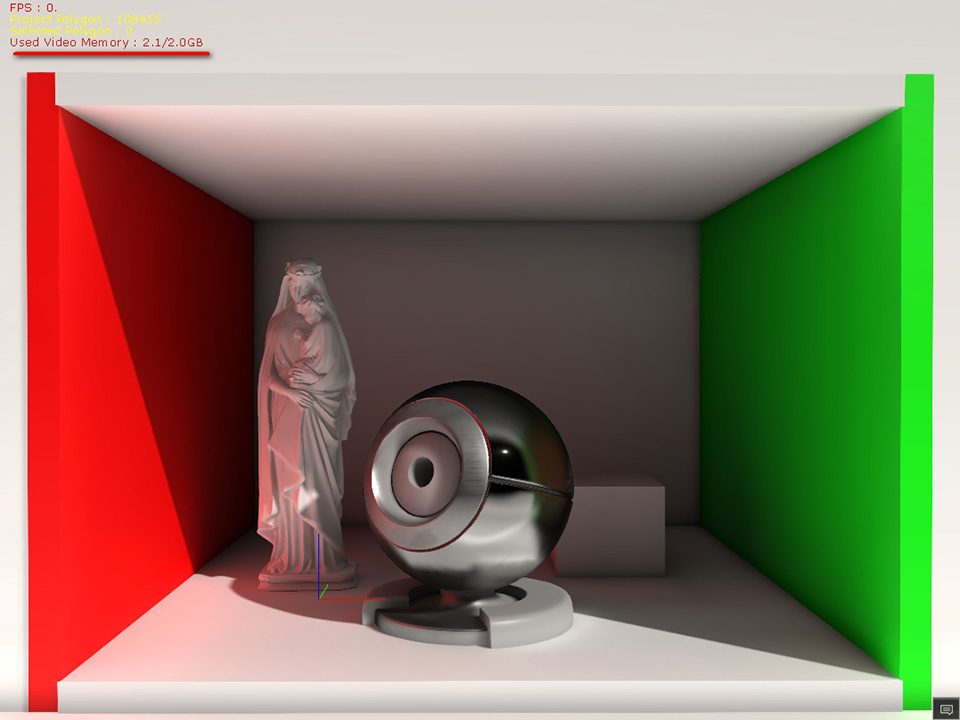

Video Memory Usage
Due to VXGI consuming large amounts of GPU memory, if found to be inefficient, it will start to utilize system memory (at this point the FPS in iClone may drop by half)
Once the memory burden exceeds capacity then iClone may promptly shut down. Provided is a tool for detecting video memory usage:

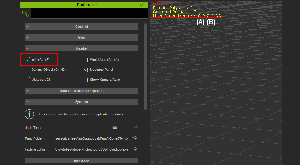

Accessing HUD (Heads Up Display) for "FPS" and "Used Video Memory"
- Used Video Memory
The new Used Video Memory information is provided for checking the amount of memory used by iClone.- Turn on "Info" display
- Checked Preference > Display > Info (Ctrl+F) to access used video memory
- the amount of video memory currently used by iClone.
Yellow text: the memory usage is within range of what the video card can provide.
Red text (as shown below): the memory usage is beyond the range of what the video card can provide.
- The total size of the video memory.
