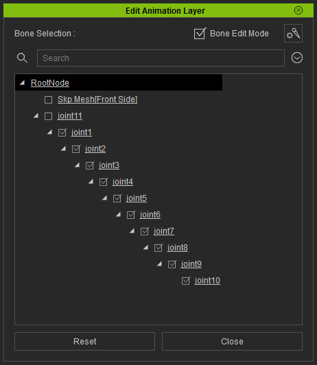

Click on the Prop, then switch the Modify panel to the Animation tab and click the Edit Animation Layer button to access the panel.
At the top-right corner, you may see the Bone Edit Mode checkbox and the Bone Settings button.

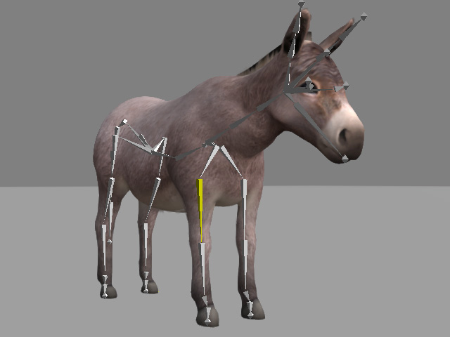

- Bone Edit Mode: Activate to view the bone structure of the object for
accurately picking the part of the object.

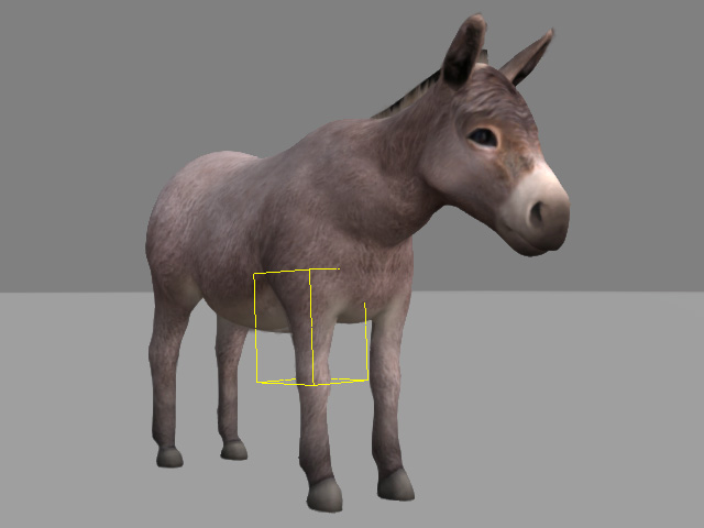

Deactivate it to view in bounding box mode.
Bone Mode.
Bounding Box Mode (Wild animal content pack by reallusion only).

Pick a bone in the 3D viewer. Alternatively, you may pick
a bone by clicking on the node in the
tree view in the Edit Motion Layer panel. Click on the actor to pick the bone.

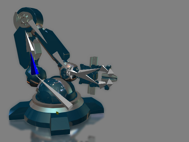

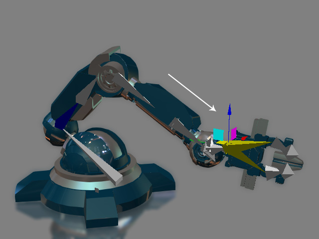

IK Method
Since IK relates to a chain of nodes, then it is necessary to anchor the head of the chain in order to move the end node with IK method.
- Select an actor and launch the panels as described in the previous section.
Select the Move
tool in the
general toolbar.
Hold down the Ctrl key and click on a node to define it as the
start of the IK chain. It will then be marked with a blue box
(You may Ctrl click again to cancel the anchor).
Please note that you may also click or Ctrl-click on the target node inside of the Edit Animation Layer panel.

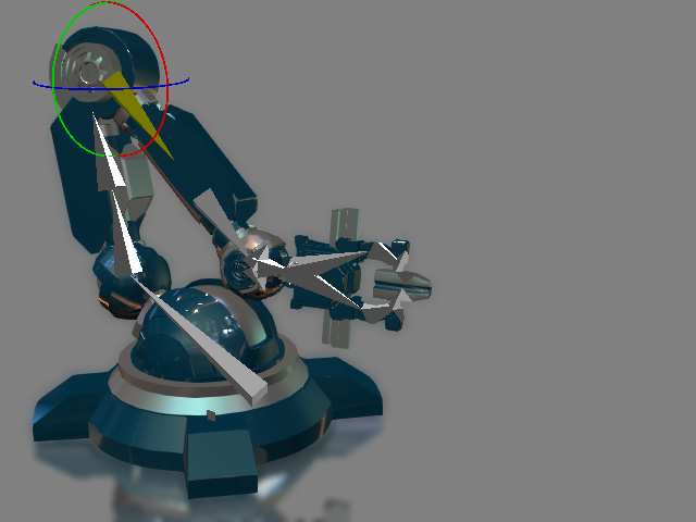

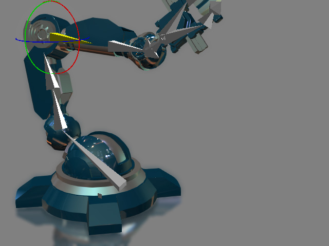

Pick another node to be the end node of the chain.
(Ctrl key released)
Use the move gizmo to move the selected bone and affect the entire IK chain.
Please refer to the What is IK/FK and How to Use IK sections for more information about IK.
