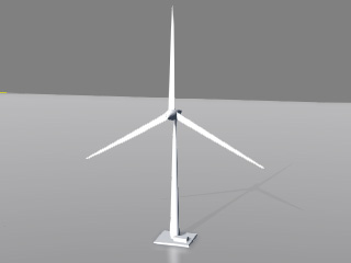

  1. Apply a prop with base part and rotating part (in this case, the chassis and the propeller of a wind turbine).
  2. Set the propeller as a Dynamic rigid body.

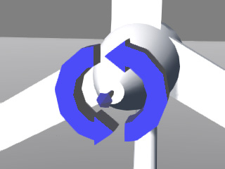

  4. Drag the Hinge Constraint template onto the motor center of the propeller.

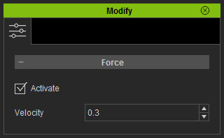

  7. Go to the Modify >> Force section. Activate the Activate box and then adjust the Velocity value to determine the speed of the motor.

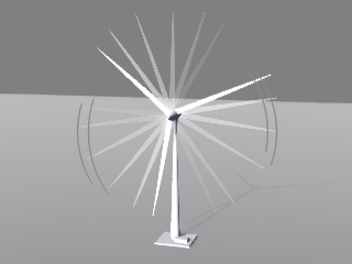

  8. Play back to simulate the result. You may need to adjust the force value of the Hinge Constraint in order to set the optimized rotation speed.
