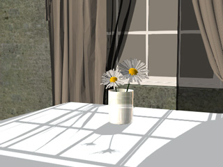

Create a project in iClone.
Auto-convert this project to Indigo for rendering.

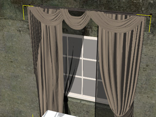

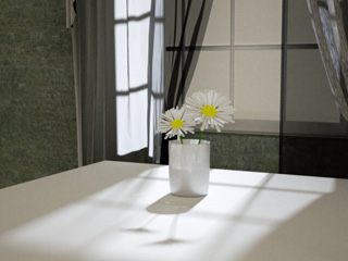

In this case, there are several objects that need specific material types. However, these
types can not be generated via the
Auto-convert Regulations.
The Curtains: Needs to be able to transmit light.
The Table: A car-paint effect may generate a better appearance.
The Glass for the flowers: Needs to be transparent.
The Water in the glass: Must also be transparent.
In this case, the Curtain is taken as an example for the next
steps.

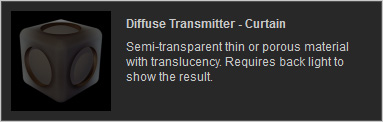

Click the Assign Indigo Shader button below the list to show a library
of embedded shaders.
Pick the desired shader from the library and then click the Apply button
at the bottom of this panel (in this case, the Diffuse Transmitter).
You can see from the list that the material will be replaced by the one indicated in the Preset column.

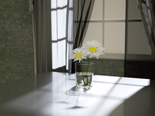

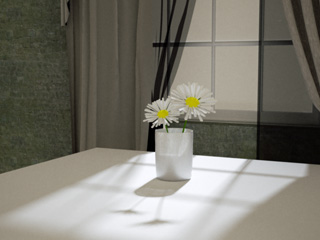

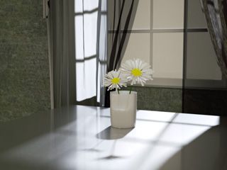

Render the scene again in Indigo.
Repeat the same steps until every material type is replaced to your satisfaction.

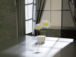

The Table: The Coating - Car Paint shader is
applied.
The Glass for the flowers: The Glossy Transparent
shader is applied.
The Water in the glass: The Indigo Specular
shader is applied.
