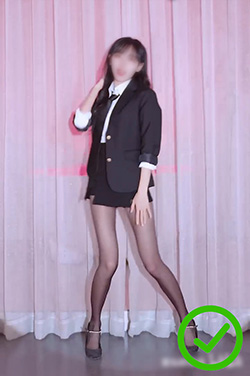

Actor Conditions
  • Video Mocap does best with real human beings. Non-humans such as monsters, chibi style, and game avatars are poorly captured.
  • Ensure that the actor size is not too small and that it's size stays consistent (no extreme zooms or dollies).

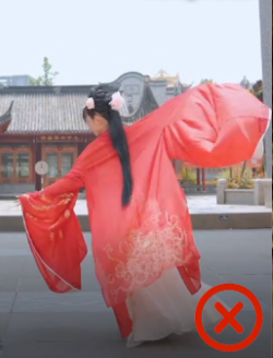

  • For full-body mocap, the entire body must be clearly visible. Ensure the limbs are not covered by clothing.
  • For upper-body mocap, at least the body from the pelvis up must be clearly visible.
  • Ensure the feet touches the ground if legs are to be captured.
  • Hands should be clearly visible for finger tracking.

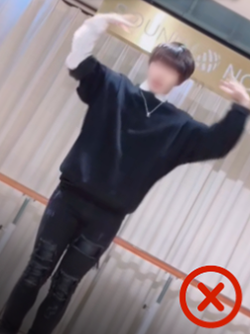

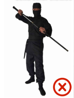

  • Actors should not be wearing clothes of a similar color to the background.
  • Actors should not wear solid color clothes.

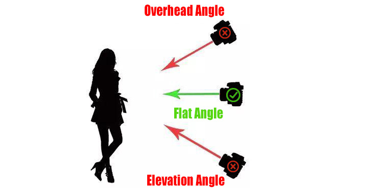

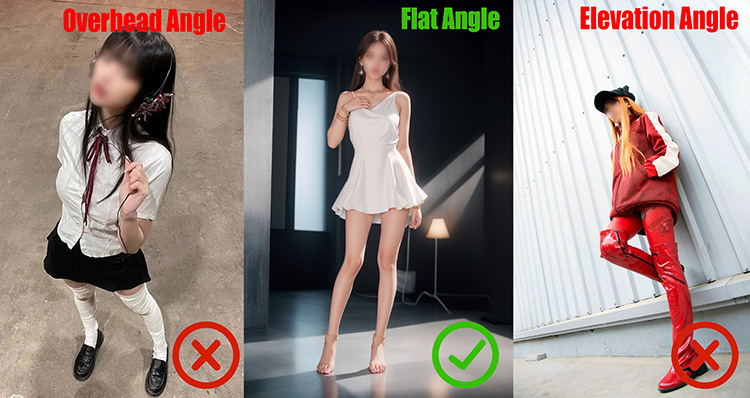

  • Use a flat viewing angle. An overhead view or elevated view may cause the action to lean forward or backward.

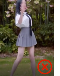

  • Avoid occluded hands, like running fingers through hair.
