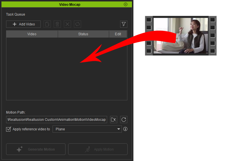

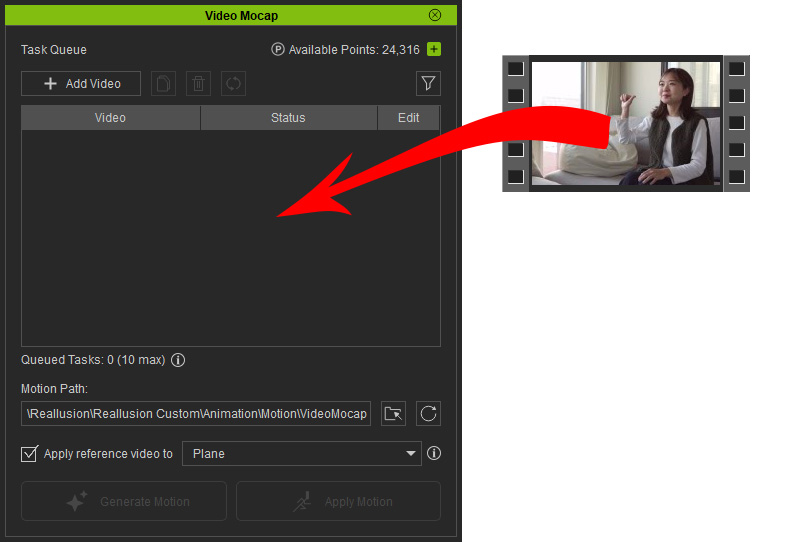

- For example, import a video of a person performing sign language into Video Mocap.
Make sure at least the body from the pelvis up is clearly visible.

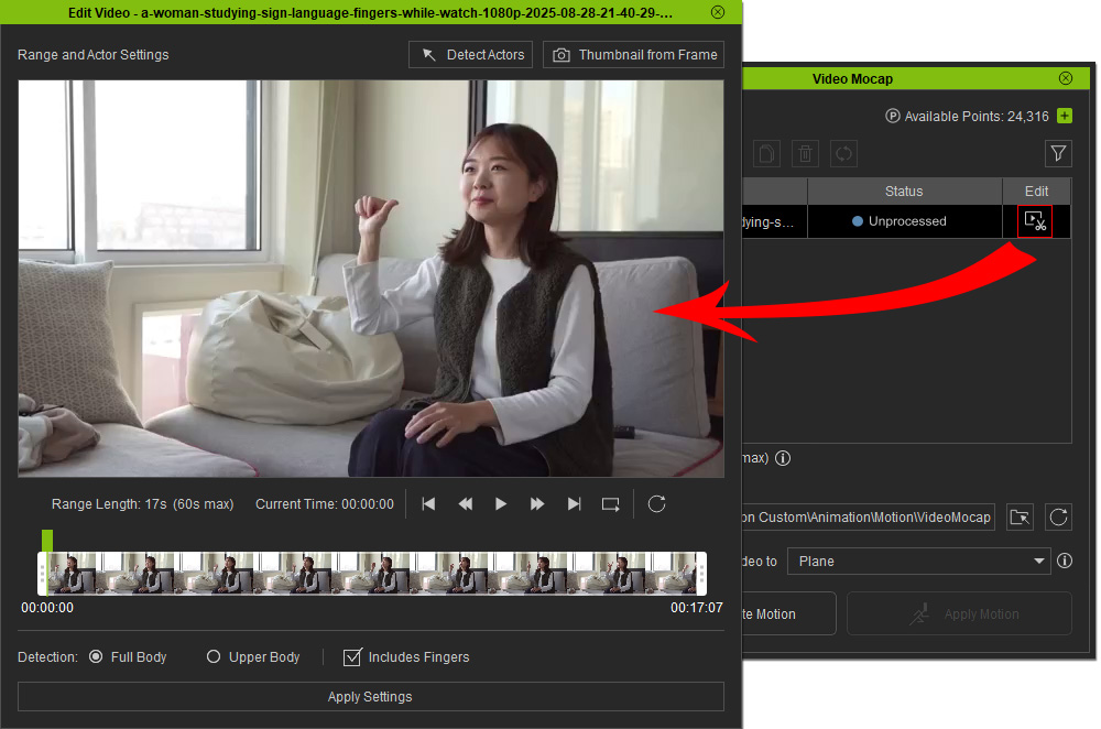

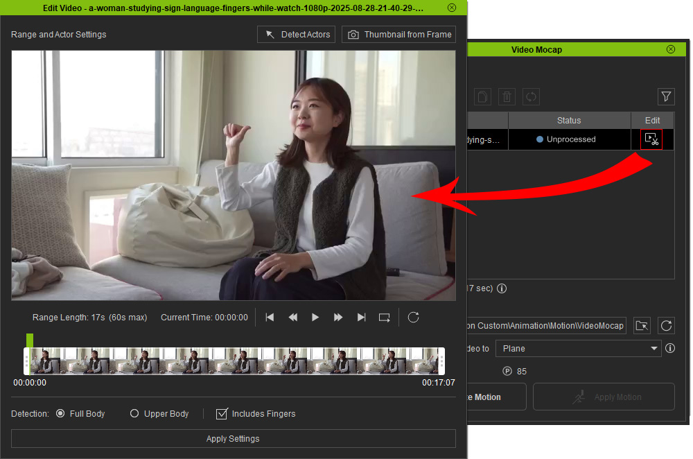

- The Edit Video panel will appear automatically.
Alternatively, select the imported video in the Task Queue, and click the Edit button to open it manually.

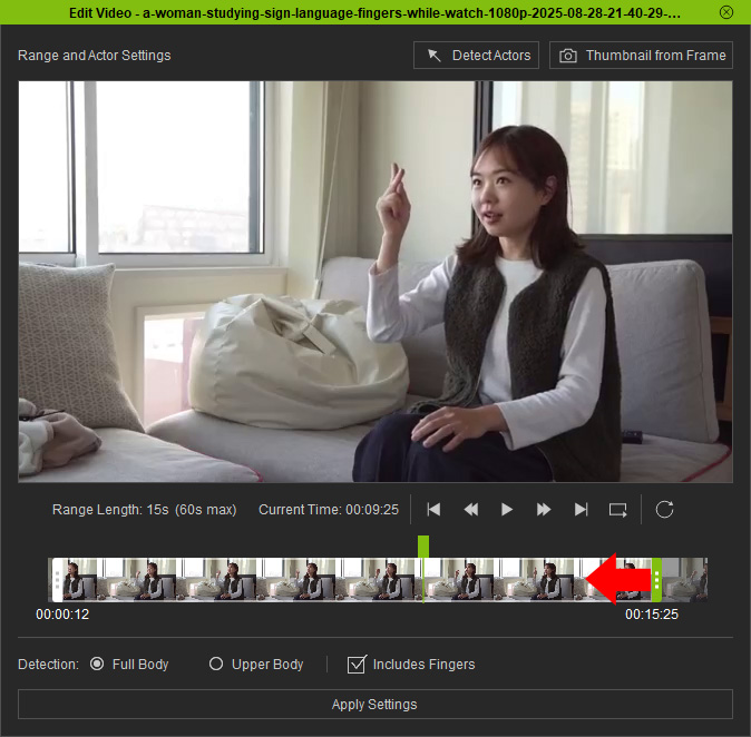

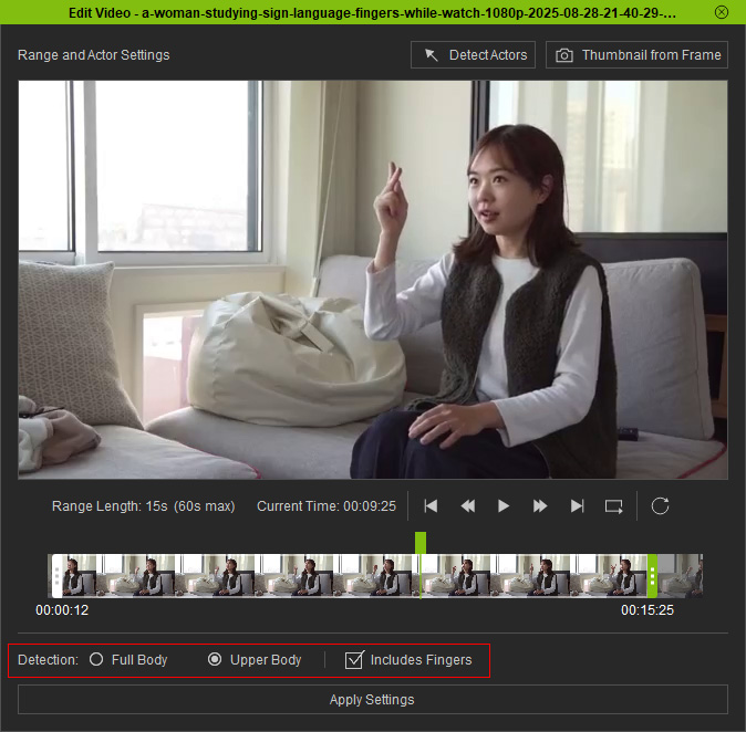

- Preview the video and trim it to isolate a region for processing.
Set the Start Time and End Time for the motion capture length (between 1 to 60 seconds), or hover over and drag the range to several frames behind to focus on motion in another range.
- Select the Upper Body for motion capture in the Detection section.
Enable the Includes Fingers to capture finger motion.
Click the Apply Settings button at the bottom to confirm your settings and exit the window.

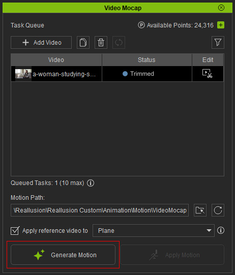

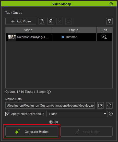

- Return to the Video Mocap panel, where the task status should now display as "Trimmed".
Click the Generate Motion button near the bottom-left corner, and review the task price displayed above the button before proceeding.

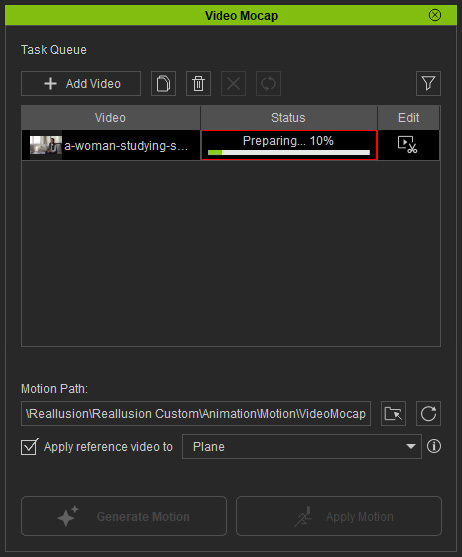

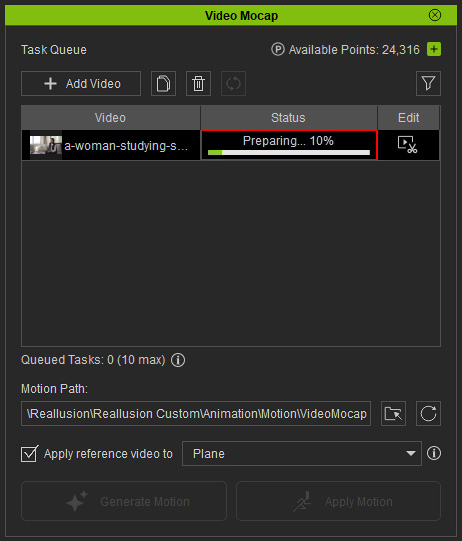

- In case of errors, monitor the progress bars shown on the Status column while the processing (may take 5–8 minutes to complete).

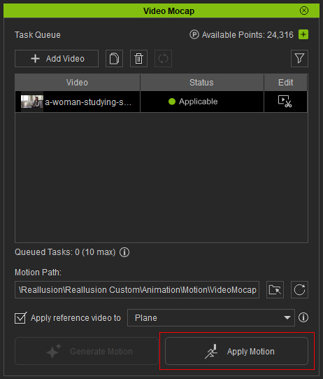

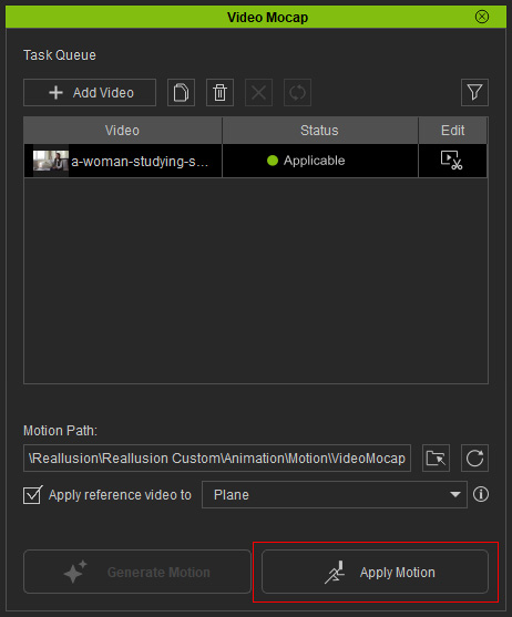

- Once the motion is successfully generated, the task status will display "Applicable".
You are now able to click the Apply Motion button near the bottom-right corner to apply the motion to a selected character in the scene.
