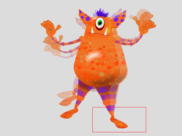

You probably see the feet not fixed in the original place when the character acts.

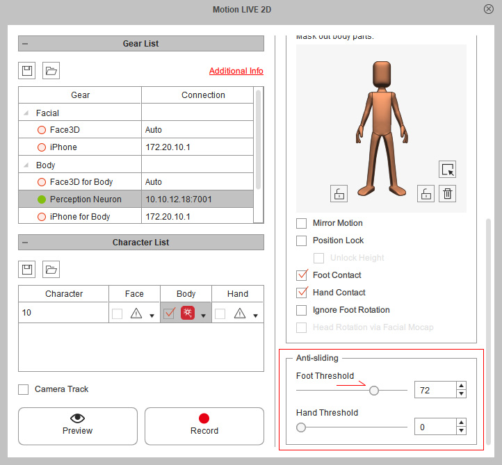

In the Anti-sliding section,
increase the Foot Threshold by dragging the slider to the right to stabilize them.
Notice that the higher Anti-sliding values, the higher possibility to retard the motions or even lose the motions of the feet or hands.
Note- By double-clicking on the name of the sliders, you can reset the values back to default.

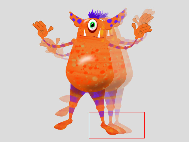

Now the foot sliding issue can be significantly reduced.
