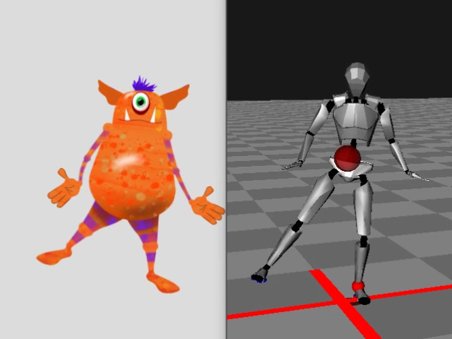

- Body Parts Mask: Select different areas of the mask for capturing motions of the corresponding body parts.
The body parts highlighted in color means that they are able to receive motion input. - Select All: Select all body parts of the mask for motion capture.
- Clear: Deselect all body parts of the mask for motion capture.
- Lock: Stick the foot in place.
By default, all the body parts are selected for full body Capture.

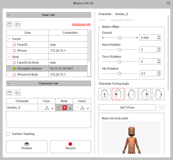

In Cartoon Animator, apply a character and make sure it is selected.
- Click the Motion LIVE 2D
button to open the Motion LIVE 2D panel.
Connect to a body mocap device in the Motion LIVE 2D panel.
Click the Preview
button to preview the body motions.
You will see all body parts can receive the motion input.
Click the Record
button to start recording.

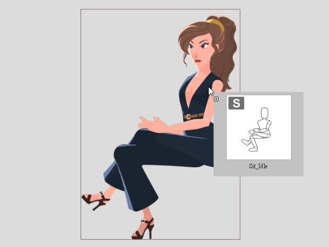

- Choose a motion clip as the motion blending source.
In this case, Sit_Idle.

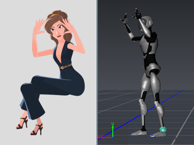

Select the masked parts from the Mask Pane.
In this case, click on the right leg and the left leg to deselect them.
- Go to the start frame of the applied motion clip.
Click the Preview
You will see that the two motions are blended into one.
Only the upper body receive the body mocap data.
Click the Record

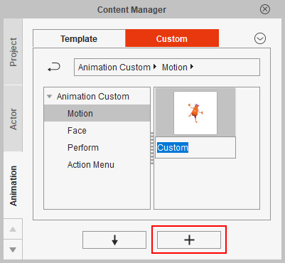

Make sure the character or the motion clip is selected.
Go to the Content Manager > Animation > Motion folder and click the Add button to save the clip (in *.ctBMotion format) under the Custom tab.
Drag the saved motion clip onto the desired character and watch it move.
