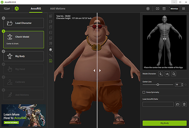

  2. Set the center line on the hips.

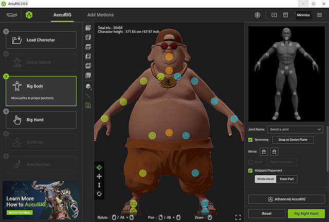

  3. Go to the third step and set up the body joints.

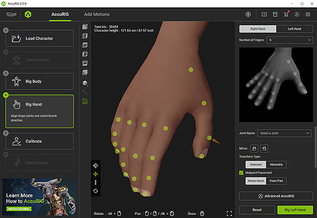

  4. Proceed to the fourth step (Rig Hand) and set up the finger joints and the thumb directions.

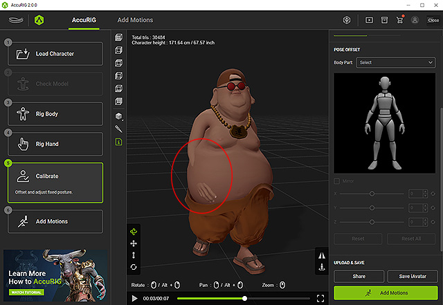

  5. Go to the fifth step to characterize the model, then apply either of the motions for testing.

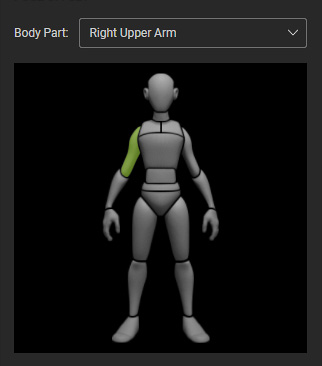

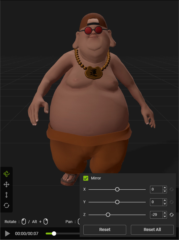

  6. Select a specific bone (in this case, the shoulder bone) by picking from the dummy in the pictogram.
    You can also choose the bone from the Body Part drop-down list.

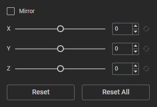

  7. The controls under the pictogram are enabled.
    • Mirror: Activate this check box to adjust bilateral bones together.
    • X, Y, Z sliders: Set the value by dragging the sliders or type numbers into the numeric field to rotate the selected bone by three axis.
  8. Adjust the bones' orientation to keep the limbs away from the body.
    If you are satisfied with the result, you can save the character as iAvatar for use in Character Creator and iClone.
