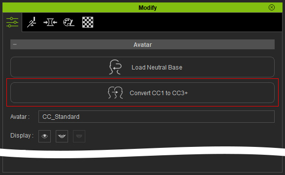

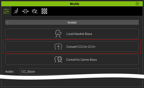

- Open a project or load a character (CC1 Base or CC3 Base) that is created from or embedded in Character Creator v3.2 or earlier.
- Open the Modify panel. Switch to the Attribute tab, in the Avatar section, click the Convert CC3 to CC3+ button.
If the character is CC1, then the button label becomes Convert CC1 to CC3+.

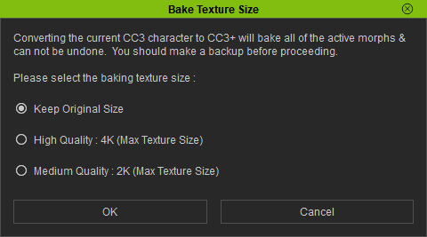

- You can determine the final texture size after conversion:
* Note that the either selection inevitably degrades the textures for the conversion.- Keep Original Size: Convert all textures to CC3 Base+ compatible textures in the original size.
- High Quality (4K): Some of the textures need to be converted to 4K (4096 x 4096).

- Medium Quality (2K): Some of the textures need to be converted to 2K (2048 x 2048).

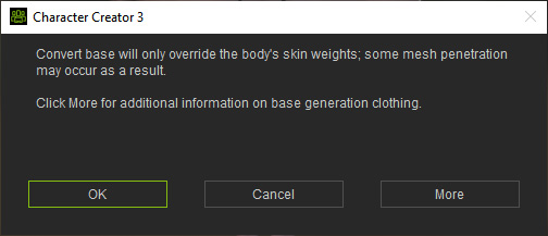

- Character Creator will show the following warning message:
- OK: Continue conversion.
- Cancel: Abort conversion.
