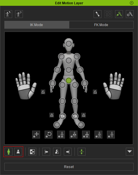

Execute the Modify >> Edit Pose command to open the Edit Motion Layer panel (shortcut key: N).
- Select an effector point from the pictogram.
Use the
tool to move the body part with
the gizmo.

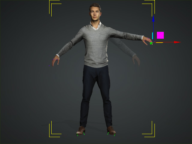

Select the hand effector point for moving the chest bone.
Move upward.
Full Body and Body Part
Given a pose to the character. When you move the limb effector points, the Full Body and Body Part mode can have different results.
- Full Body:
When you move any effector point, the torso may be driven along.
Please note that only in Full Body mode can you select multi effector points for moving or rotating at once (Ctrl + Click on effector points). - Body Part: If you only want to move the limbs or head, then choose this radio button.
