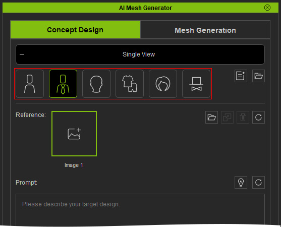

  1. Launch AI Mesh Generator panel.
  2. Choose the workflow for generating Concept Design view (in this example, Single View).
    • Single View: Start the Concept Design by using only the front view image as the Mesh Generation source.
    • Multi-View: Start the Concept Design by using four view images (front, right, left, back) as the Mesh Generation sources via the AI Studio.
  3. Set Mesh Type (for example, Full Design).
    ** For Clothes: Select the appropriate Part before setting up the View Set.
  4. Provide a Reference Image and/or Prompt Text (Preset).

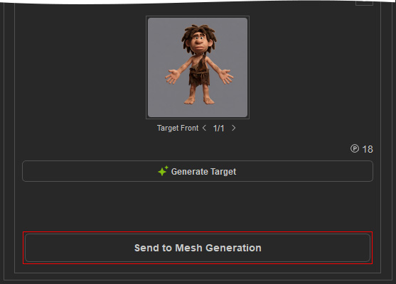

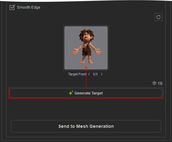

  5. Click Generate Target and select a satisfactory Target Front image (Left / Right arrow buttons).
  6. When the view is ready, click the Send to Mesh Generation button.

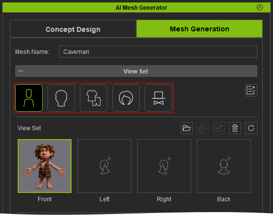

Step 2: Set Up the View Set

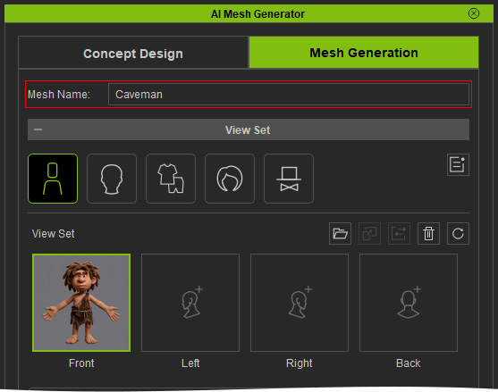

  1. Enter the name of the generated mesh in the Mesh Name field.
  2. The generated image (step 5) is transferred to the View Set > Front slot in the Mesh Generation page.
    ** Make sure the Front View is available. The Left, Right, and Back views are optional but can improve the accuracy of the generated mesh.
    See Setting Up the View Set and Generating Multi-View Reference Images for details.
  3. Make sure that the Mesh Type setting matches the one selected in the Concept Design tab.
