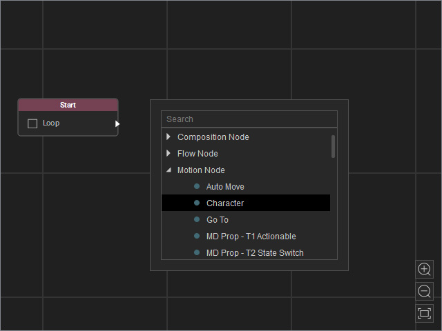

  3. Open the MP Node Graph panel. Right-click on the viewport space and choose Motion Node > Character.

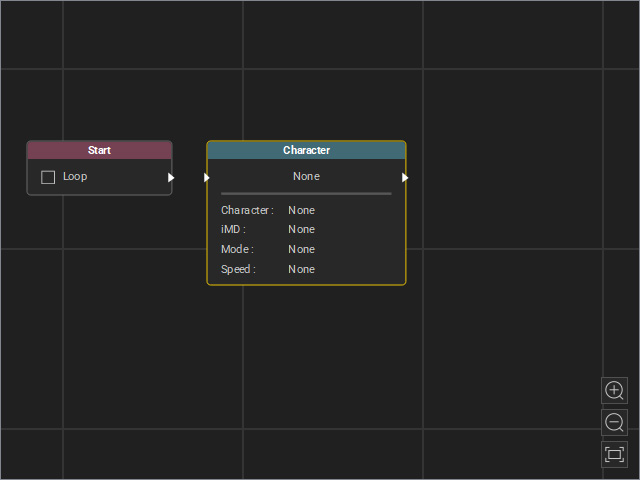

    A new Character node will be inserted on view.
  4. Drag a flow line from the Start node’s output and connect it to the Character node’s input.
    Note that you can also associate object and MP node with Pick from Scene method.
  5. Select the node and adjust the settings in the Attributes page. Note that some of these settings are related to the Behavior Settings tab in the MD Behavior panel.
