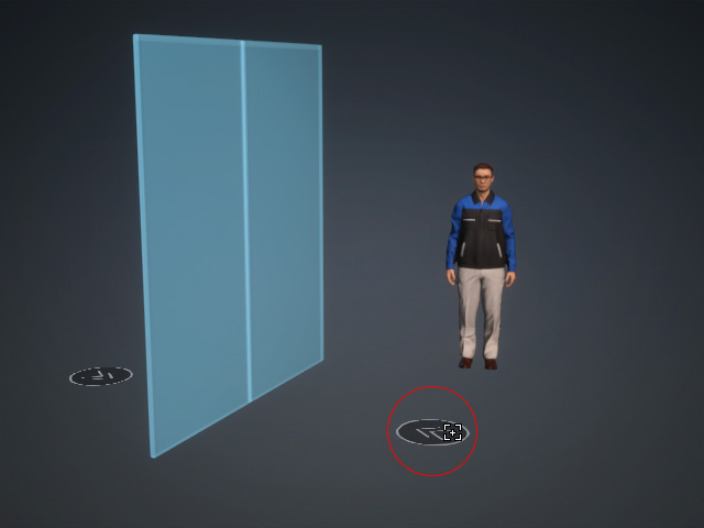

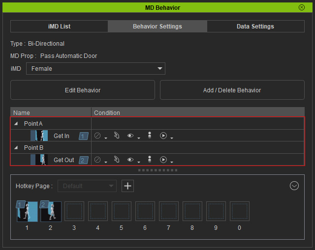

- Create a project with a character and a T3 Bi-Directional MD prop.
- Select the MD prop and open the MD Behavior to observe the integrated interaction motions.
You can also use Adding Behavior Motions feature to add more Transition Enter or Exit motions to the behavior list.

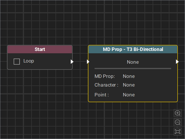

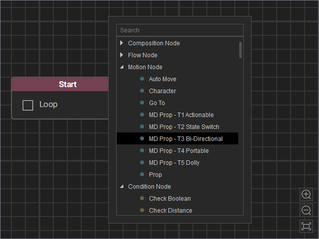

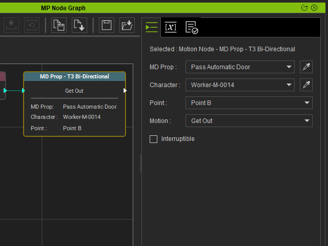

- Open the MP Node Graph panel. Right-click on the viewport space and choose Motion Node > MD Prop - T3 Bi-Directional.
A new MD Prop - T3 Bi-Directional node will be inserted on view.

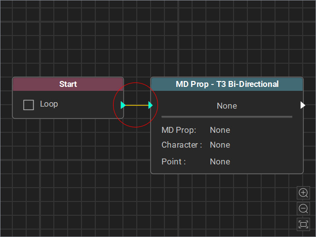

- Drag a flow line from the Start node’s output and connect it to the MD Prop - T3 Bi-Directional node’s input.

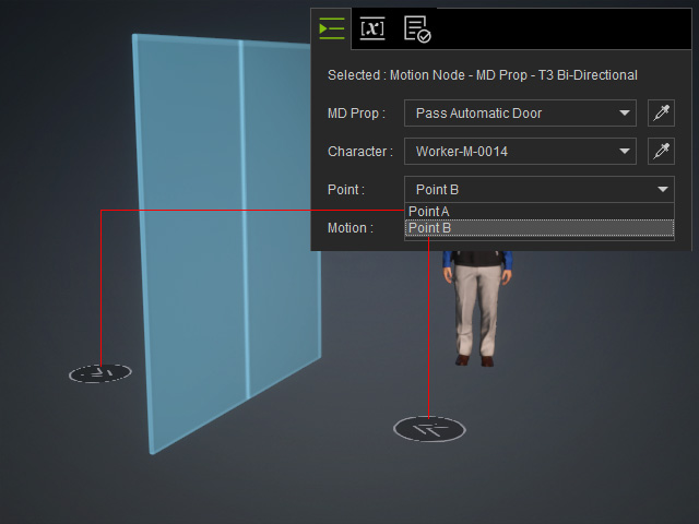

Note that you can also associate object and MP node with Pick from Scene method. - Select the node and adjust the settings in the Attributes page.

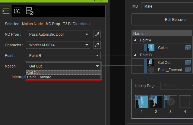

- MD Prop: Set the field to associate the node with the target MD Prop. If you use the dropper tool, click the waypoint marker (the flat disk with double arrows) instead of the model’s mesh.
- Character: Set the field to associate the node with the target character.
- Point: Selects the waypoint for the character to move to before performing the motions embedded in the waypoint.
- Motion: Select the desired motion (embedded in the waypoint) to be triggered by the node when the flow proceeds to this node.
- Interruptible: When used together with a node from the Condition Node category, the motion driven by this node can be forcibly interrupted.

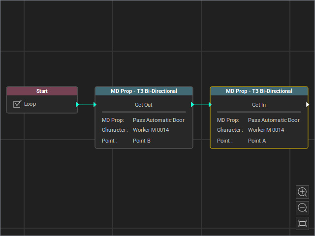

- Connect a new T3 node after the previous one and set the Point to Point A and the Motion to Get In. The character will then move through the mesh again with the embedded animations.
Start Go MD mode again to view the result.
