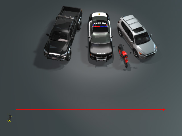

  1. Create a project in iClone with an animated camera.
    Switch to the camera perspective and playback to view the result:

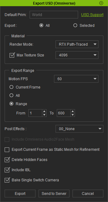

  1. Launch the Export USD panel and adjust the settings.
    • Export: Choose to export All or Selected objects. The currently supported objects are Characters, Props, Lights and Cameras.
    • Render Mode: Since the character's shader type is Digital Human Shader, which contains SSS (sub-surface scattering) settings, this setting should be set to RTX Path-Traced.
    • Export Range: Export a range of the entire project in order to export the motion and expressions of the character.
    • Include IBL: Activate this checkbox to export the IBL of the project since the lights in the projects are not exported.

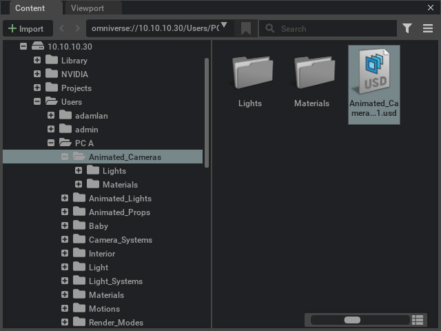

  2. Click the Export or Send to Server button to export USD file (in this case, Send to Server).
Adjusting and Rendering via Omniverse Applications
  1. Launch Omniverse Create or View. Open the USD file previously exported from iClone.

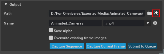

  3. Open the Rendering > Movie Capture panel and adjust the settings for the final rendering.
  4. Click the arrow button.

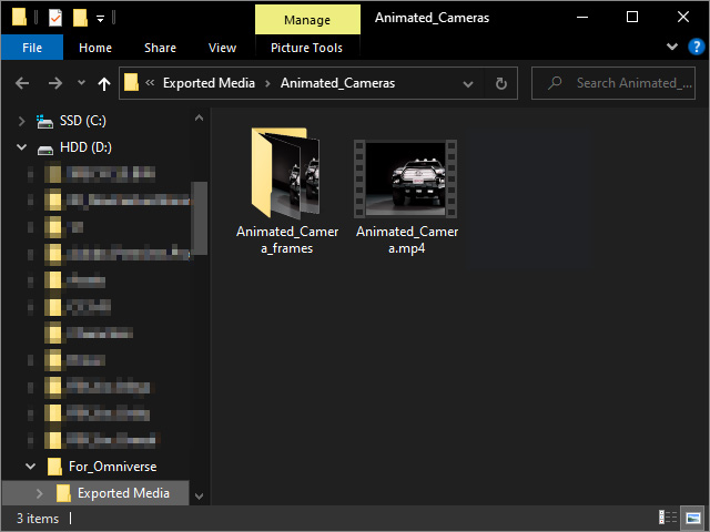

    You can find the rendered file in the pop-up explorer.
