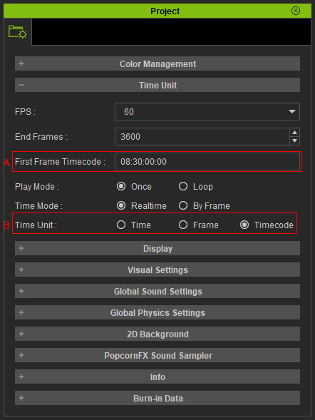

Project Settings
A |
Custom Timecode Start |
Type in a desired time to set the start timecode of the project. The digits represent Hour (H) : Minutes (M) : Seconds (S) : Frame (F). |
B |
Time Unit |
Choose the desired unit displayed on timeline measure. |

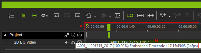

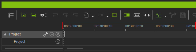

Timeline
A |
Timecode for Start Frame |
Displays the timecode unit determined in Project Settings panel. |
B |
Clip Timecode |
Displays the timecode of the clip's start frame. |

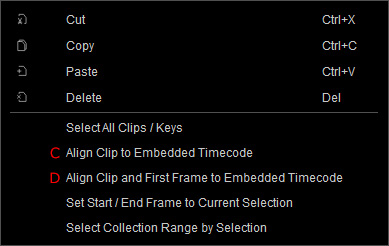

Right-click on either clips including timecode, you will see the two commands in the context menu:
C |
Aligns the current clip to correct timecode frame. |
D |
Sets the project start frame to the same timecode as the clip's first frame. |

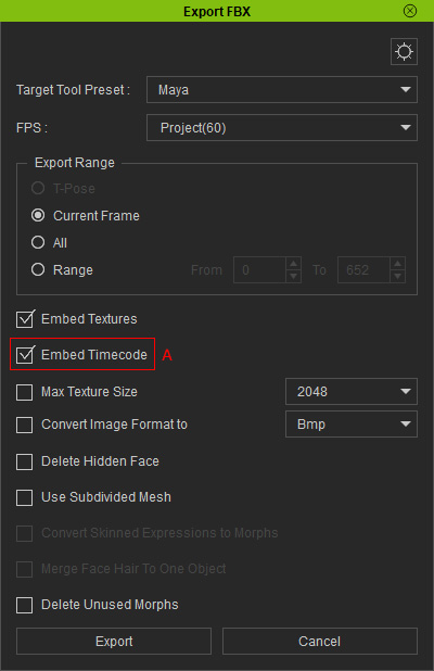

Export FBX
A |
Integrates timecode data into the exported FBX file. |

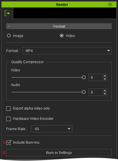

Render Panel
A |
Overlays the timecode on the screen of the exported image or video. |
B |
Opens the Project Settings > Burn-in Data section for further adjustments. |

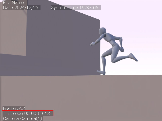

View Port

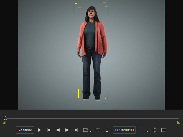

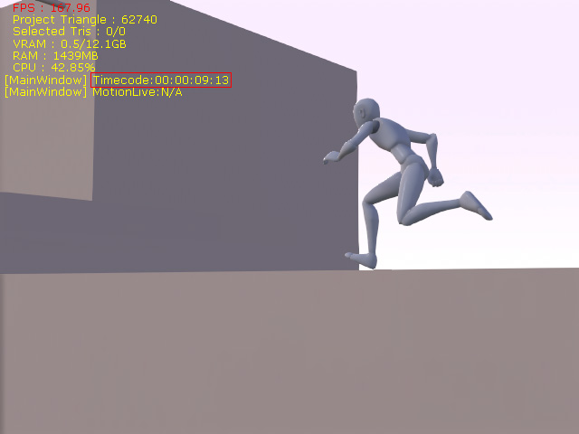

There are two methods to display the current timecode of the project.
Enabled timecode by pressing Ctrl + F. |
Or enabled timecode via Project Settings > Burn-in Data. |
