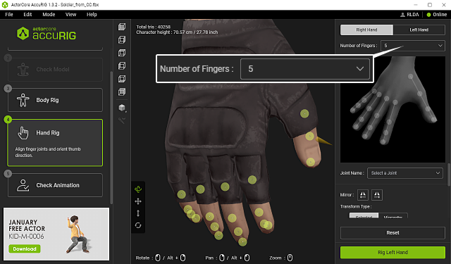

  6. Before proceeding to step 4, you will be asked to input the number of fingers for the character.
  7. AccuRIG will automatically position the finger joints. You can manually reposition them if needed.
    Click the Left Hand tab or Go to Left Hand button for the same adjustments to the other hand. Proceed to the final step by clicking the Check Animation button on the left side panel.
