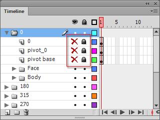

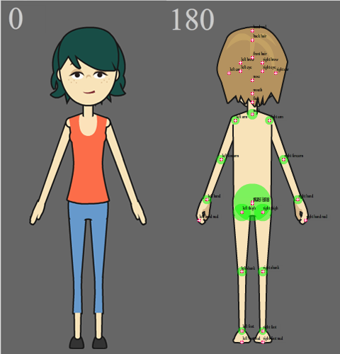

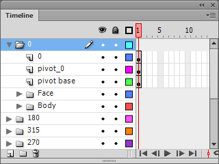

  1. Open the downloaded Dummy_Template.fla in Adobe Flash (CS4 or above).
  2. Expand the 0 folder in the timeline because we are about to modify the character in angle 0.
    • Do not edit any sprite in the 0, Pivot_0 and Pivot base track unless you're very familiar with their purpose.
    • You may hide or lock these three tracks to avoid accidentally editing the symbols in them.

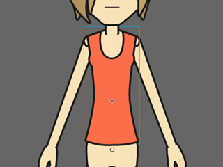

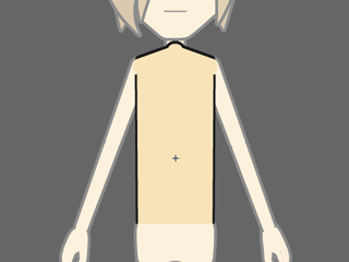

    • In the following steps, the Upper Torso is taken as an example.

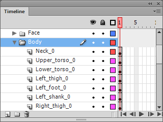

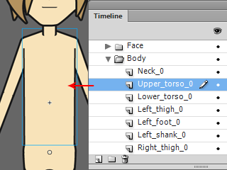

  3. Expand the Body folder to show its sub-tracks.
  4. Select the Upper_torso_0 track, and the upper torso symbol will be highlighted. (because the Upper Torso, a movie clip symbol, is stored in the first frame of the track.)

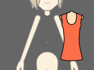

  5. Double click on the upper body symbol to open it.
  6. Draw a new upper body.
  7. Delete the dummy's original upper body.
  8. Align the new upper body to an appropriate position.
  9. Double click on the empty area to envelop the symbol and the body part is thus ready for use.

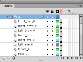

  10. Follow the same steps to replace the facial features symbols (they are under the Face folder in the timeline).
    Please refer to the Creating Multi-pose Elements section for creating a multiple pose facial features.

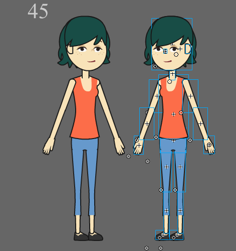

  11. Show the symbols in the Pivot track. Adjust the pivots' positions as described in the Setting Pivots section.

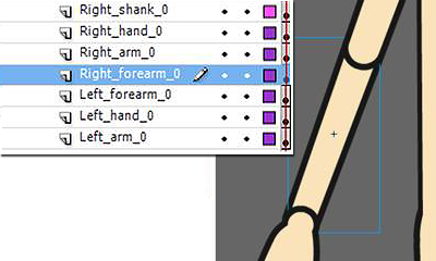

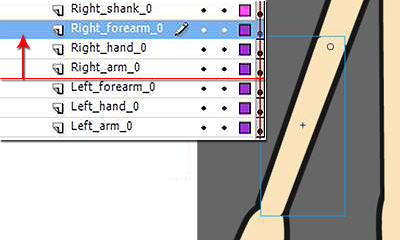

  12. Change the layer order by moving up or down the tracks according to the joint styles.
    Move the track up or down to change the layer order.
    Please note that the layer order in Angle 0 is the base order. Even if you set different orders for other angles in Flash, the final character's sprite layer order in each angle will be determined based on the one in Angle 0 in CrazyTalk Animator 2 after you click the Confirm Multi-angle Settings button.

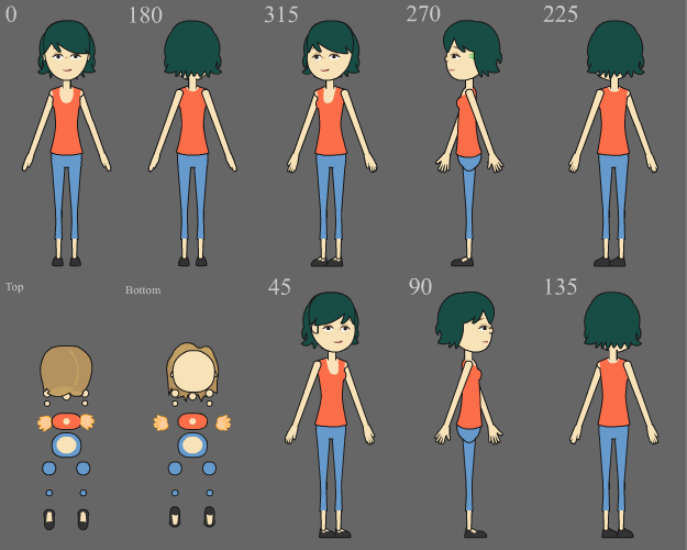

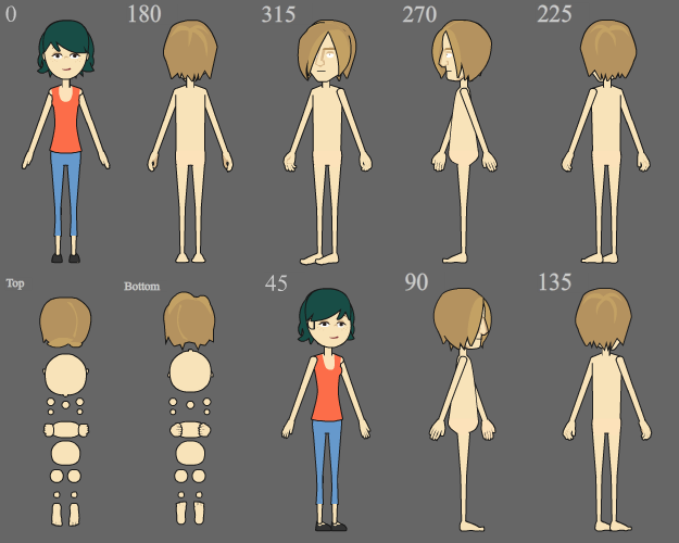

  13. When you replace the entire character's symbols in each track, then that particular angle profile is ready..

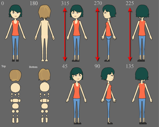

  14. Follow the same steps to replace all character sprites for each angle. Alternately, you may use the advanced skills described in the next section.
Copy and Flip for Symmetrical Character
You may use the previous steps to replace the character sprites in each angle profile one by one, but if you want to skip the redrawing steps, you can also utilize the Copy and Flip skill.

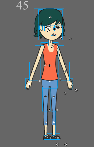

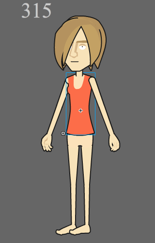

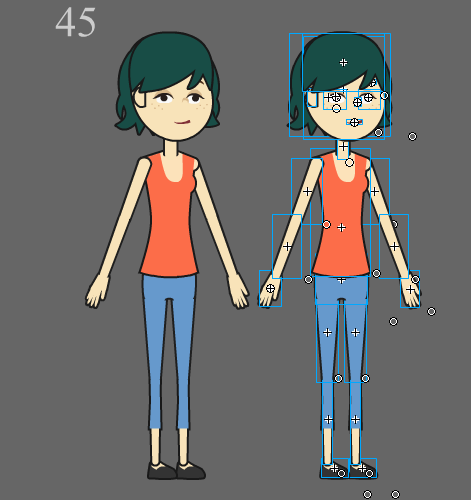

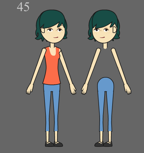

  1. Make sure you have correctly replaced a character in an angle (in this case, 45 degrees).
  2. Select all of the replaced symbols of the character from the stage.
    Hide the Number, Pivot, and Pivot Base tracks because you do not need them for this skill.
  3. Copy the symbols.
  4. Create a new track on the timeline and name it Temp.
  5. Select the first frame of the temp track and paste the symbols.
  6. Deselect the symbols that you do not need to horizontally flip (such as the front and back hair, the eyes and the mouth).

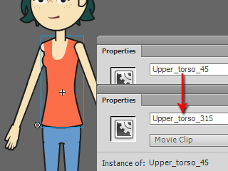

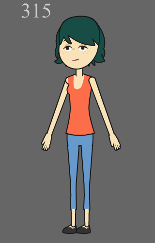

  7. After horizontally flipping the character, the sprites can be used for the 315 degree profile.
  8. Follow the naming rules to rename every sprite of the flipped character.
    Rename all the sprites according to the naming conventions.

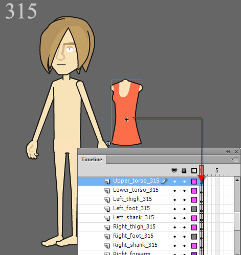

  9. Cut the symbol (in this case, the renamed upper torso) from the temp track.
  10. Paste it into the first frame of the target track of the symmetric angle (in this case, the upper_torso_315 track).
  11. Relocate the symbol and remove the original one.
