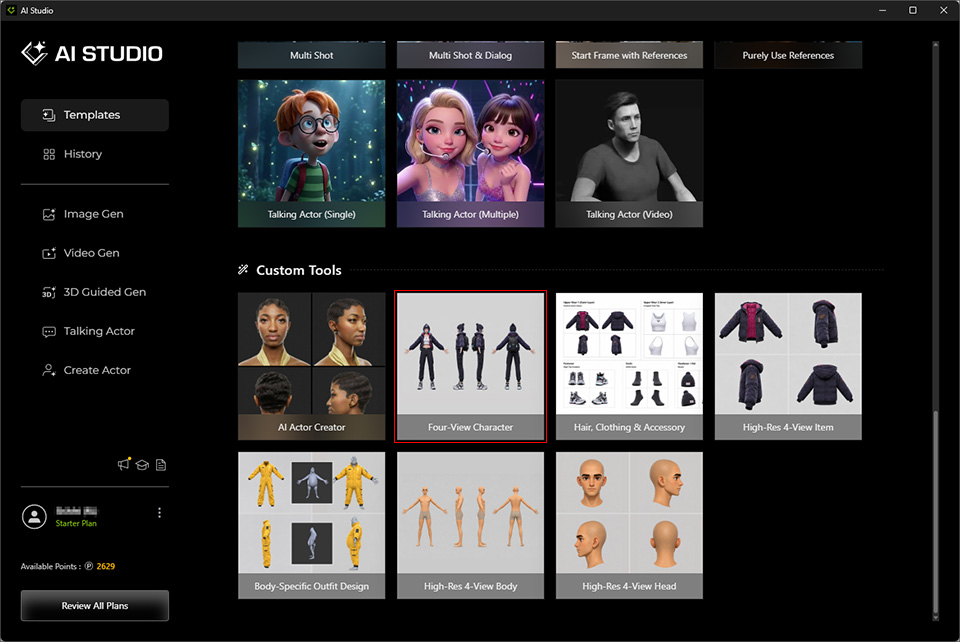

In AI Studio, go to Templates > Custom Tools to explore all 6 template tools. Click the Four-View Character template to open it.

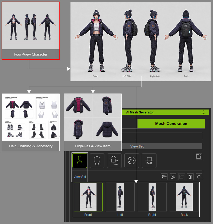

The Four-View Character template generates a single image containing front, left, right, and back views in A-Pose from any character images or photos. The image can be used as source image for the Hair, Clothing & Accessory and High-Res 4-View Item templates in AI Studio or the target images in the View Set of Character mesh type in AI Mesh Generator.

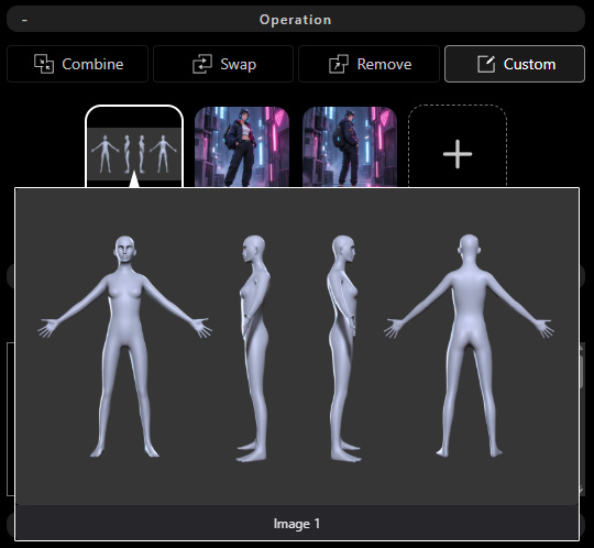

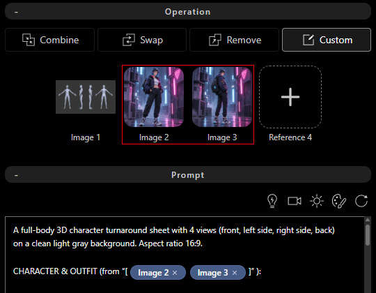

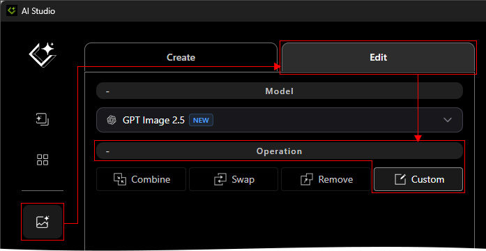

  1. After the template opens, AI Studio automatically goes to Image Gen > Edit > Custom (under the Operation section).
  2. Keep Image 1 unchanged, as it defines the four viewing angles for the AI.
  3. Replace Image 2 and Image 3 with images of the character you want to generate. You can remove either image, but at least one reference image is required.
    ** You can use one or multiple reference images to provide the character's appearance. Ensure the images depict the same character for consistent results.

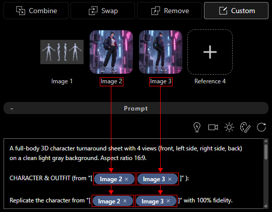

Update the Prompt

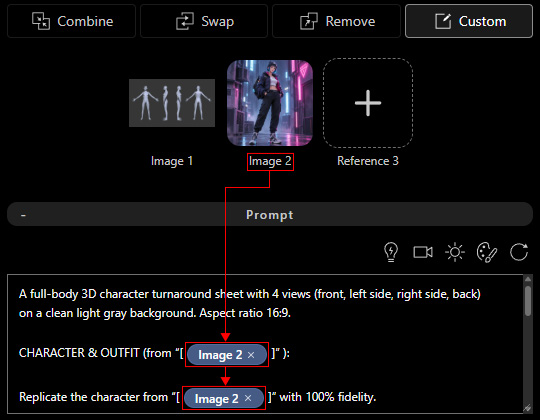

  1. The prompt is preconfigured. Do not modify its content except for the image references in the CHARACTER & OUTFIT section. Make sure the image references match the number of reference images used above.
    • One reference image:
      CHARACTER & OUTFIT (from "[ Image 2]"):
      Replicate the character from "[ Image 2]" with 100% fidelity.
    • Two reference images:
      CHARACTER & OUTFIT (from "[ Image 2 Image 3 ]"):
      Replicate the character from "[ Image 2 Image 3 ]" with 100% fidelity.
    • For additional reference images, follow the same pattern and include all corresponding image slots.

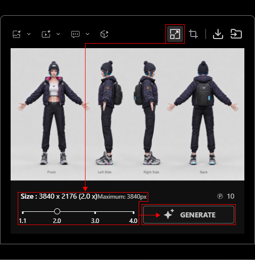

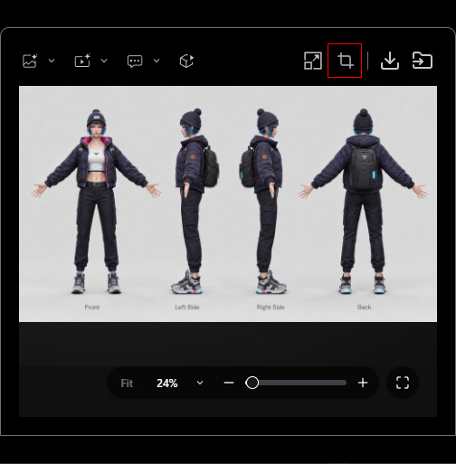

  2. Click GENERATE to generate a four-view character image. If you are not satisfied with the result, click GENERATE again to generate another image.
Upscale the Image (Optional)
If needed, use Upscale to increase the image resolution.

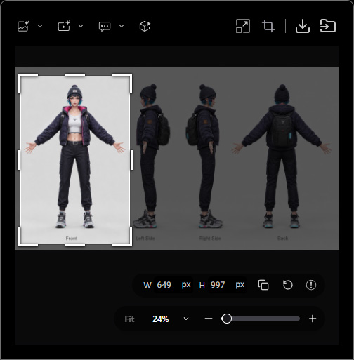

Copy Each View

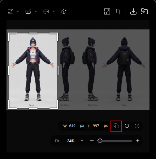

  1. Select the Copy to Clipboard tool.
  2. Select one view from the generated four-view image.
  3. Click Copy below the selection, or press Ctrl + C, to copy the selected view to the system clipboard.
Import Views into AI Mesh Generator
  1. Open AI Mesh Generator and go to the Mesh Generation page. Enter the Mesh Name.
  2. Make sure that the Mesh Type setting matches the one copied in the AI Studio. In this example, select Character.
  3. Under View Set, select the slot corresponding to the one in step 8 (Front, Left, Right, or Back).
  4. Click Paste image from clipboard, or press Ctrl + V, to paste the copied view.
  5. Repeat for the remaining views. A Front view is required; the other views are optional.
