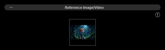

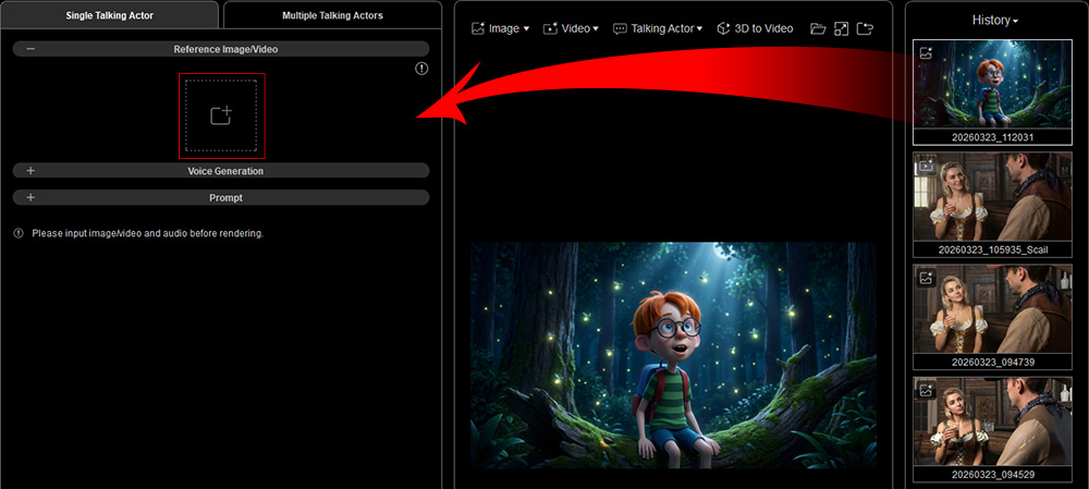

- In the Reference Image / Video section, click the Media slot to browse and upload a reference image (.png, .jpg, .jpeg, or webp) or video (.mp4, or .mov) containing the target actor for speech generation.
You can also drag an image or video directly from the History panel on the right or from Windows File Explorer.
Note that long videos will be automatically trimmed to 30 seconds. - The media will be inserted into the Media slot.
Hover over the media thumbnail to view an enlarged version, or click the Trash button to remove the current input.

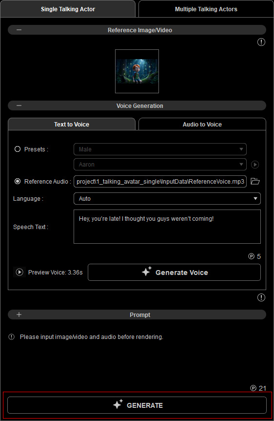

The actor's voice can be uploaded via Audio to Voice or generated via Text to Voice (TTS).
Text to VoiceText to Voice uses Text-to-Speech (TTS) technology to generate audio from a text script, using either preset voices or voice cloning based on reference audio.

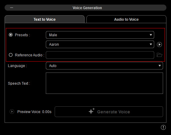

- Under the Text to Voice tab in the Voice Generation section, select a voice source method for speech generation: Presets or Reference Audio.
- Presets: A selection of male and female preset voices is available in the drop-down list across different AI Actors, allowing you to assign a voice to the actor in the video.
Click the Play button to preview the selected AI voice. - Reference Audio: Click the Folder icon (A) to upload a pre-recorded voice file (.mp3, .wav, or .flac) for AI voice cloning of the speaker’s tone, pitch, and accent.
You can also drag and drop audio directly from the History panel on the right (B) or from Windows File Explorer into the field.

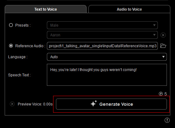

- Enter the actor’s dialogue in the Speech Text field.
Use expressive interjections or emotional prefixes to enhance vocal emotion.
For example, "Hey, you’re late! I thought you guys weren’t coming!".
The AI model will automatically detect the input language. - Click Generate Voice to create audio from the current text using the selected voice source.
Note the task price displayed above the button before proceeding.
- Track progress on the AI Render View or via the new entry in History on the right.
When the submission completes successfully, the AI-generated audio will appear.
Click Play to play the audio, Loop to repeat playback, or drag the playhead to jump to a specific point.
- Review the Preview Voice information to see the generated audio length, as it will be automatically trimmed to match the video duration (up to 30 seconds).
Click Play next to it to preview the voice audio.

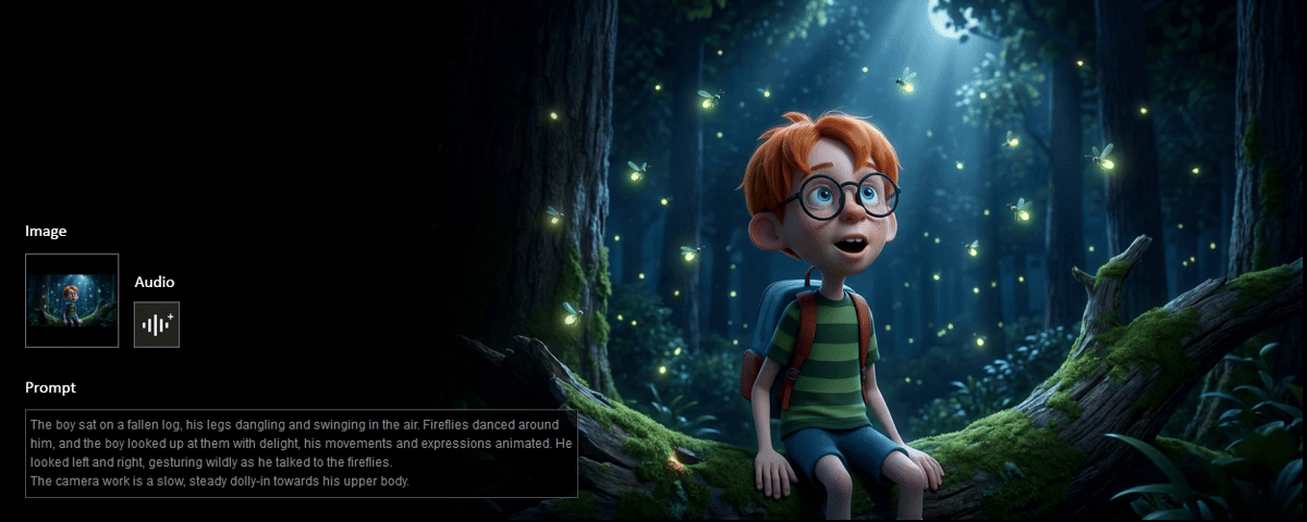

Enter prompt descriptions in the Prompt section to define the scene and control the actor’s state and emotion in the generated video.
For example, "The boy sat on a fallen log, his legs dangling and swinging in the air. Fireflies danced around him, and the boy looked up at them with delight, his movements and expressions animated. He looked left and right, gesturing wildly as he talked to the fireflies.
The camera work is a slow, steady dolly-in towards his upper body".
Drag the bottom-right corner to expand the text field for longer descriptions.
Click the Reset Prompt button to clear the prompt field and start over if needed.
